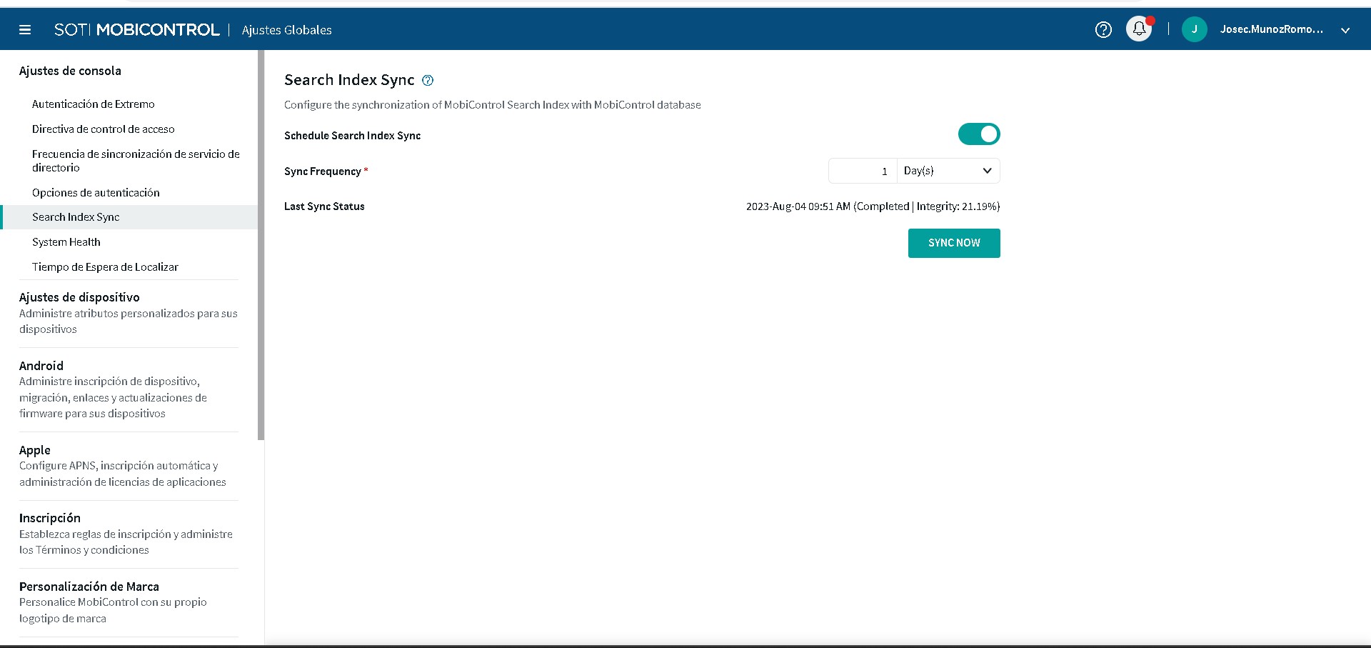

I would request you check your search integrity under Global Settings> Search Index Sync. If it is less than 90%, please click on Sync now, then you can see the device on the MobiControl web console, if it was enrolled properly and you can see the agent is connected in to the device MobiControl agent.
If your search sync is failing, I would request you to open a support case here and someone from Technical Support Team can help you
Please find attached a screenshot for your reference.

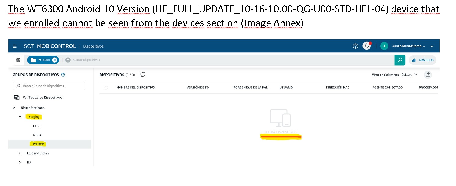

3 years ago
I can't see my device yet
JM
Josec Munoz Romo
3 years ago

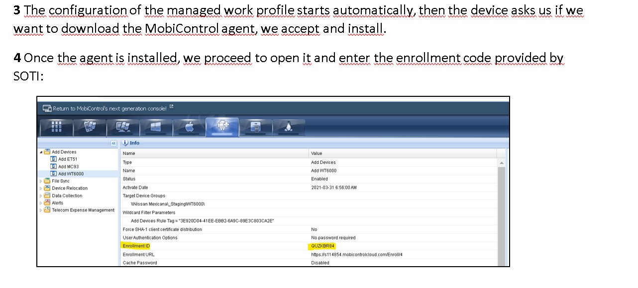

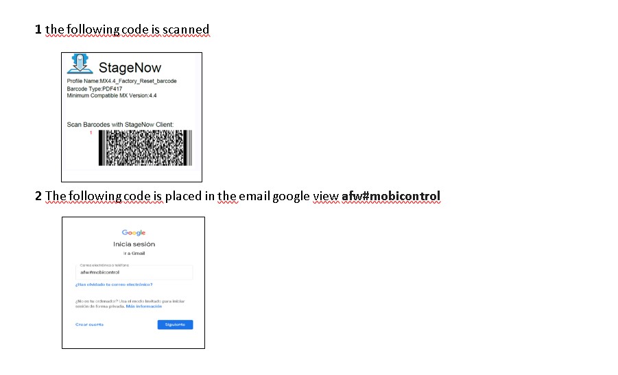

added enrollment process that we are carrying out as well as the problem

Hi Josec,
Thank you for your quick response.
I would request you to do a Search Sync again, as I can see from the image that your search integrity is around 21%, so please make sure it is above 90%. If your search sync is failing, I would request you to open a support case here and someone from Technical Support Team can help you.
