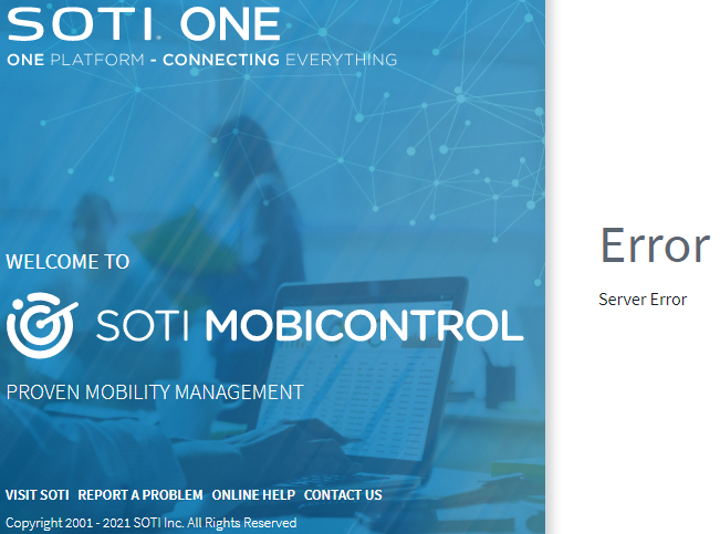

When users attempt to access the SOTI MobiControl application through SOTI Identity (SSO solution), they may encounter an error on the SOTI MobiControl login screen.
The error message displayed on the MobiControl Login Screen
