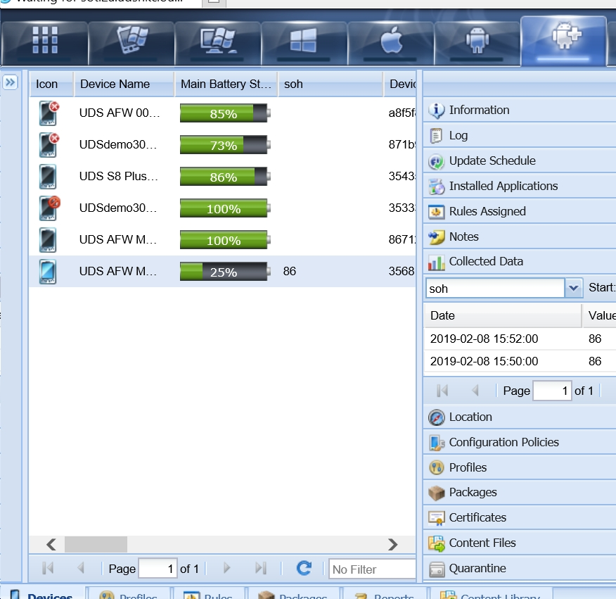

As I said in my last post, you need to add an arbitrary section name, and then choose INI file.  For the screenshot attached in previous post,  I cut and pasted your example text file as the base, and add the line
[main]
as the first line of the INI file.  In the custom data definition,  "main" was used as the "Section Name", and "soh" as the "Value Name".   This works also for v14.x.

It would be nice to obtain this soh value and present next to each device using custom data.
It should be quite easy to do, as long as you have a section name added at the top of your file.
I spent a few minutes to get it done on a v13.4 test server as shown in the screenshot below :
