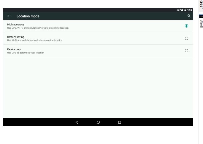

With that said, have you tried using watchsettings on script to capture the setting change that you're referring to? RC is very likely right about that particular setting not being controllable but if it is possible to configure it via writesecuresetting then you'd need to identify the setting name and value with watchsettings first.

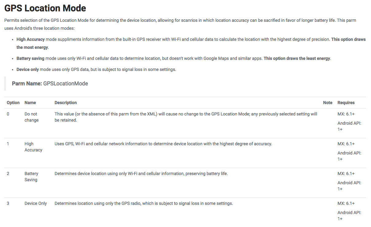

If that doesn't work you may need to resort to a manufacturer specific management API such as the Zebra MX layer. This configuration option is in fact available to Zebra Android devices through MX but unless that's an ET55 tablet you're not going to be able to leverage MX:

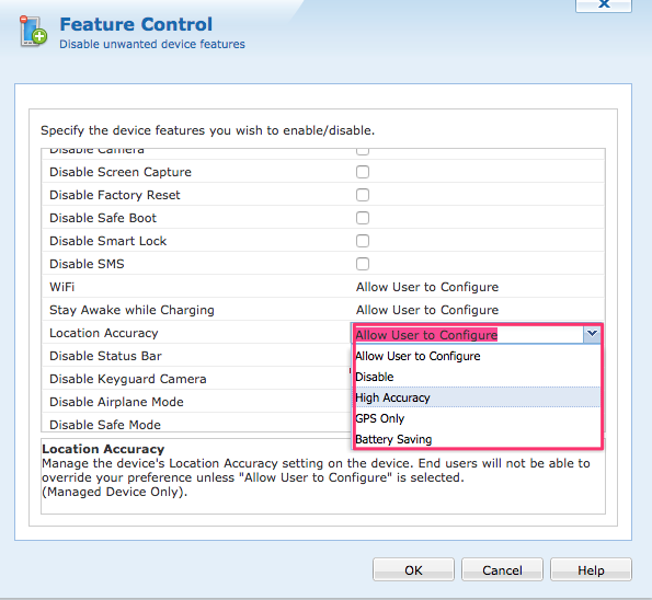

Come to think of it, this is also a feature of Android Enterprise Feature Control in SOTI 14.x:
