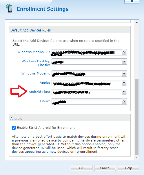

Another option would be to define the rule created as the default rule for Android Plus. That way, when you are asked for Enrollment ID you can enter the server IP address or server name or this url https://servername/Enroll
You can find this in Global Settings -> Enrollment Settings
