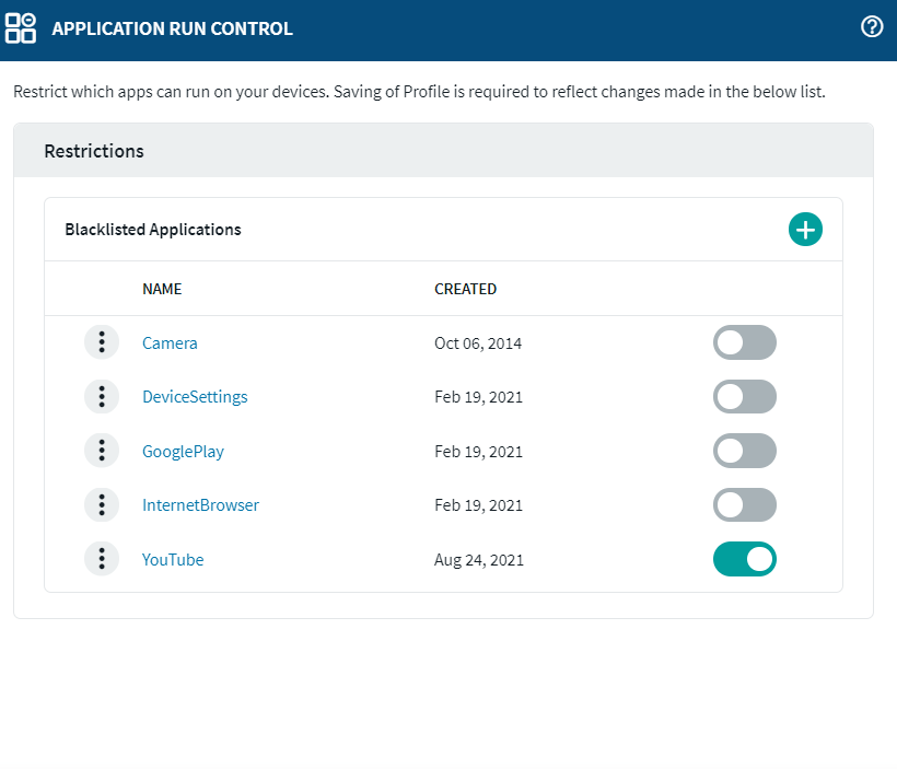

As the title describes, I'm trying to blacklist youtube using the Application Run Control, but youtube is still remaining on the endpoints.

Have you checked the profile status to confirm that the application-run-control/feature-control payload has been successfully deployed to the targeted devices?

I have confirmed the payload status is 'Installed' on the target device.

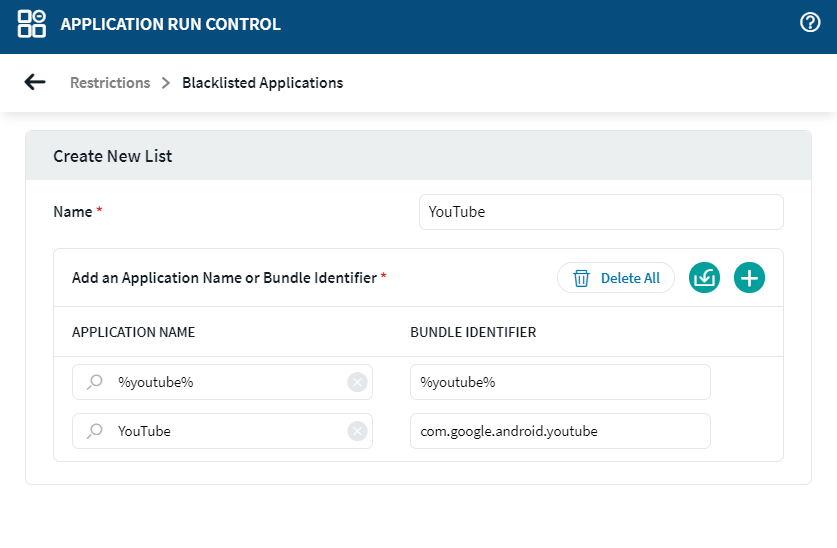

Is Youtube app a built-in app that comes with the firmware? Or did you deploy the app from Managed Google Play store ?
Have you tried leaving out the first entry (i.e. the item with %youtube% macro's) in your application-run-control profile and see if there's any difference?

Youtube and Youtube Music came factory on these units, not from google play. I removed the first macro like you suggested and completed a soft reset. Unfortunately I am still able to launch Youtube on the endpoint. I forgot to mention, the status for youtube under 'Application' is 'uninstalled'.

Thnks for your new information about the app reported  "uninstalled" status and the existence of two Youtube apps.  Have you done anything to confirm the bundle-ID of the two Youtube apps running on your device?  Is it possible that your bundled Youtube apps have bundle-ID different from the default "com.google.android.youtube" that you've tried, e.g.
  com.google.android.apps.youtube.music
  com.google.android.youtube.tvmusic
  com.google.android.apps.youtube.vr
  com.google.android.youtube.googletv

I confirmed the bundle IDs are correct by opening the app on the endpoint, downloading the device log and opening the adb.log and looking for the string that contained the app I opened.
