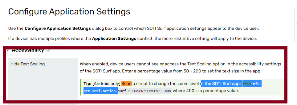

I would like to inform you that it is strongly advised to use the profile to make those changes on all the devices across the field/environment. It is easy to keep the track of changes made using the profile configurations.
However, you can perform the same action using the scripts if it is required for only one or two devices and it will not set to default until you send the script again with different value or "factory wipe" the device. The best practice is to use profiles to keep track of the changes made on the devices and payloads applied to the devices.
SCRIPT : sendinfo net.soti.action.surf BROWSERZOOMLEVEL VALUE
