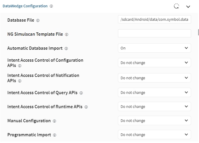

But you could use the Zebra OEM config app to set datawedge configuration which also includes setting the path etc. for the db file and then you need only to copy the db file via profile to the provided location:

wow that's great I did not know that changing this path allow us to access to .db file without DB for Android 11+. I'll try this. Thank you @Rafael Schäfer
If we can access this .db file without ADB, so what is the restriction to put it on as /sdcard/config/datawedge.db. If there is no, we may use Datawedge configuration by selecting XPert mode to export an XML file by pointing out the datawedge db location and run the XML to access the datawedge.db and do the related configuration by itself on the device, similar to mentioned here: SOTI Discussion Forum
Here is a example from mine, but I did use ADB connection to get the .db from OS11 device

Maybe we are looking on 2 different things:
Import: That' what I and the TE is talking about.
Export: What you seem to talk about. There, i don't see any other possibility than adb because datawedge seem never to ask where to export it's configuration and always exports it into default folder. Not sure if this changes if you change it with oemconfig as shown above to sdcard folder or so.

More or less both but his question was about if datawedge is able to export to different folder but the verison i have (TC51 with Oreo) has not, always displaying only the one folder). So the answer is just "no" but can be done using ADB (as you mentioned) and/or maybe with this __chmod 777 script (seen in the other topic i posted the link to) but not sure if this is still working on A11.
And the import can be realigned to different file/folder but not sure if this also has an affect for the export as we are on A8 and don't needed to change that there.
