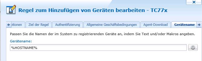

is it possible to get the devicename (in the "new device rule") automatically filled with the command "getprop net.hostname".
I read in the Manual MobiControl Help "Enter the combination of text and macros you want " :)
best regards
Marco

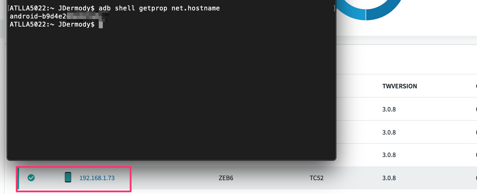

I was able to rename a device using the %HOSTNAME% macro which ended up setting it to the device's current IP address. Not sure if that is what you're looking for or not.
MO
Marco Olberts
Hi Matt, We tried with %Hostname% but it doesnt work. The Devicename is now "%Hostname%" :) It there any lists what commands are possible or how i can use another makro? We set the Hostname with HostMgr StageNow.
Did you try %HOSTNAME% ?

Marco Olberts
Hi Matt,
yes we try %HOSTNAME%:
Remote with the command "getprop net.hostname"
I'm using 14.3 so maybe its a newer feature. With that being said, when I rename the device with the %HOSTNAME% macro it seems to pull the IP address instead of the hostname that you're looking for so it may not be particularly useful anyway:
