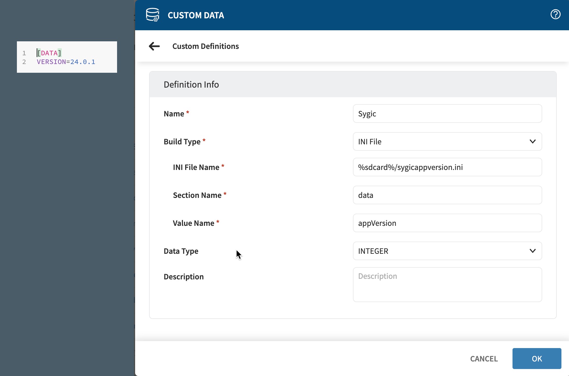

2 years ago
I used your JS to query an app's version and save it as a file, I then used the following custom data settings and it was able to read the file and display the info.
