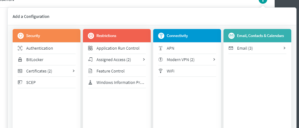

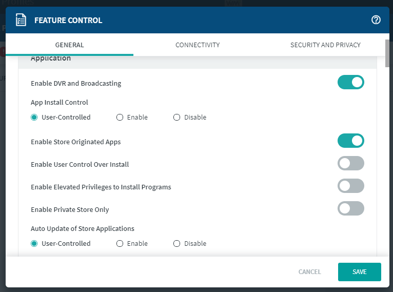

Hi, is there option to Disable Print Screen in Windows 10 ? Seems i can't find it at Feature Control Menu.
D
DDMOD@SOTI Platinum Contributor
Hi Saputra,
We do not have any such feature as Windows imposed restrictions on their default functions. Moreover, it is not recommended to disable the 'Print Screen' key of Windows 10 device.
