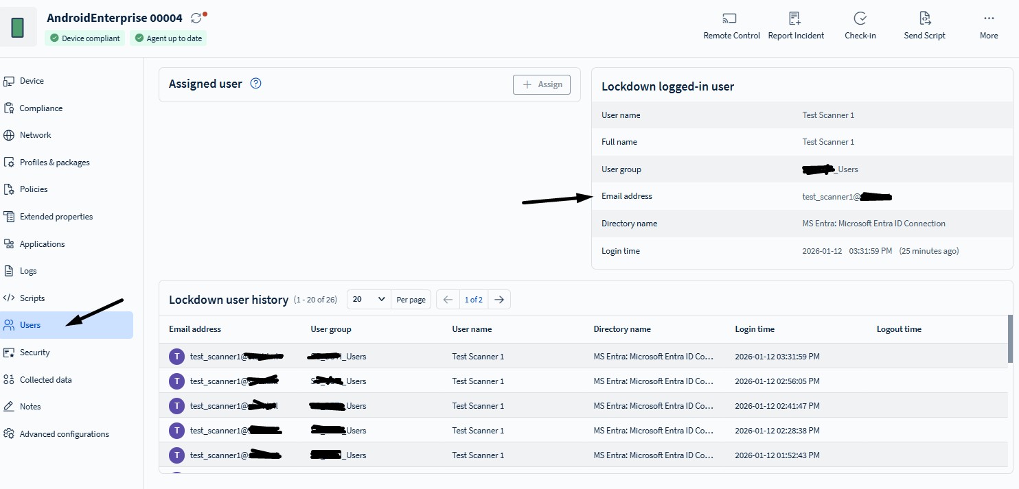

I'm building a new lockdown pre-auth and post auth with shared device login (Entra ID) (HTML coded)
Is it possible to also put a Macro in the lockdown to display information from the screen Lockdown Logged-In User?
i would like to display which user is currently logged-in on the device itself.

We have tested both options.
But i need the Entra ID (first or last name or Email) to be displayed on the lockdown after a succesfull log-in.
See attached screenshot.

Have you tried %ENROLLEDUSER_EMAIL%
This would be my next guess.

%ENROLLEDUSER_EMAIL% is not working.
Any other options?
