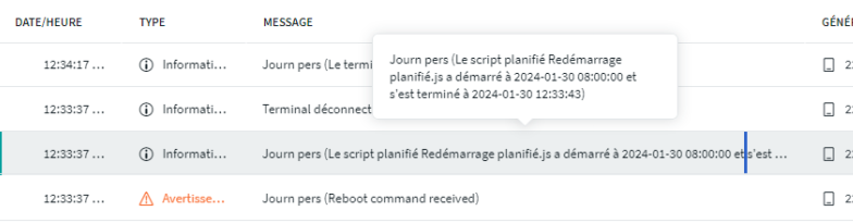

Generally speaking, this script works and the terminals restart randomly between 08:00am and 09:00am. But for some reason, some terminals restart later... And sometimes up to several hours later! And yet, they're online, the SOTI agent is up and running, and when I look at the log I see that the task was launched at 08:00am with an execution time of several hours...
What could be causing this? I'm looking for a solution because restarting a terminal outside this range is a problem...

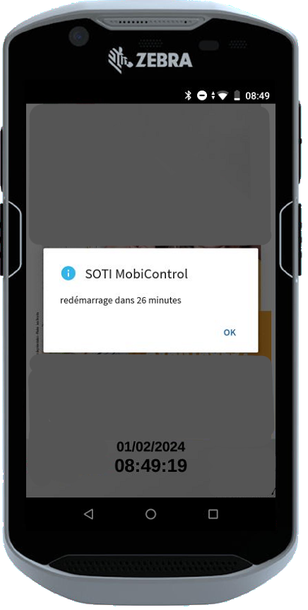

this morning, for example, this device received the script at the desired time (08:00am, device time as configured)), and indicates that it will restart in 26 minutes (calculated via the script). 49 minutes later, it still hasn't restarted.

Can the dialog maybe block that reboot then (even then it's strange that some work and some doesn't)?
So maybe put the dismiss of the dialog into the script as well like in the help:
var dialogId = mobicontrol.message.createInfoDialog('The dialog will be dismissed in 1 second.').show();
setTimeout(delayFunction, 1000);
function delayFunction() {
    mobicontrol.message.dismiss(dialogId);
mobicontrol.device.reboot; }
