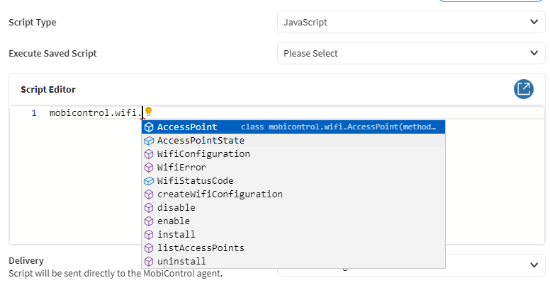

Hi, its possible by JavaScript. The documentation is here:
https://www.soti.net/mc/help/javascriptapi/en/mobicontrol.wifi.html

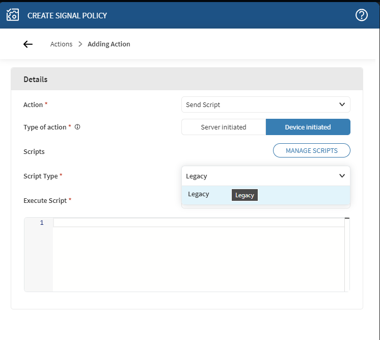

more precisely, how exactly would you do it? Is JavaScript integrable into a Signal policy?

Unfortunately, a Java script cannot be initiated by the device through a Signal policy.
It's not as you can just deploy again the already known SSID with the relevant settings and because of deploying that it can be that it connects to it but there's no "connect to" or so available in JS just pointing to a SSID to connect to like by Name or so without providing any additional connection information which are already stored on the device.

With this small JS script, i am able to switch to any configured SSID on my device:
var ProdAP = mobicontrol.wifi.listAccessPoints().find(ap => ap.ssid == 'SSID-i-want-to-connect');
     mobicontrol.wifi.enable(ProdAP);

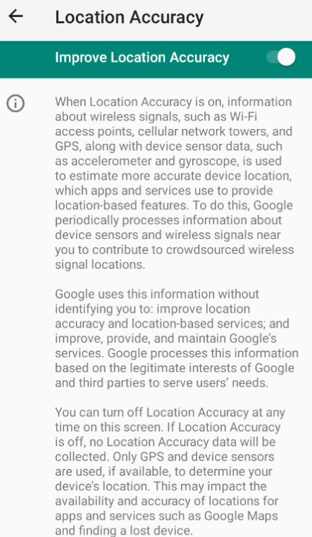

almost there...Custom log (WifiError: Location services are off. (UserScript#1))
HV
For the WifiError: Location services are off, I did raise a ticket in May 2024, as you will see the same error if you use mobicontrol.wifi.uninstall().
I fail to understand the relationship between Location services and these script commands.
Also, and that is another ticket: It is not possible to run Locations services on with MobiControl.

this should be done by a FeatureControl policy -> Location Accuracy -> you need "Battery Saving" at least (this way its working on our devices)

Hi, we also use HSM devices. But we do not configure 'Location Accuracy' with Honeywell's Enterprise Provisioner (or any other OEM tools), only by SOTI's FC Policy.

I just tested it on two CT40XP with Android 9 & 12, works for both without issue. If i set "High Accuracy",  access to location setting is blocked by admin and i see that Google apps like PlayStore and YouTube are using location service. If i set "Allow user to configure" access to location is possible for the device user and you can switch it on / off.  Also the script is working.
