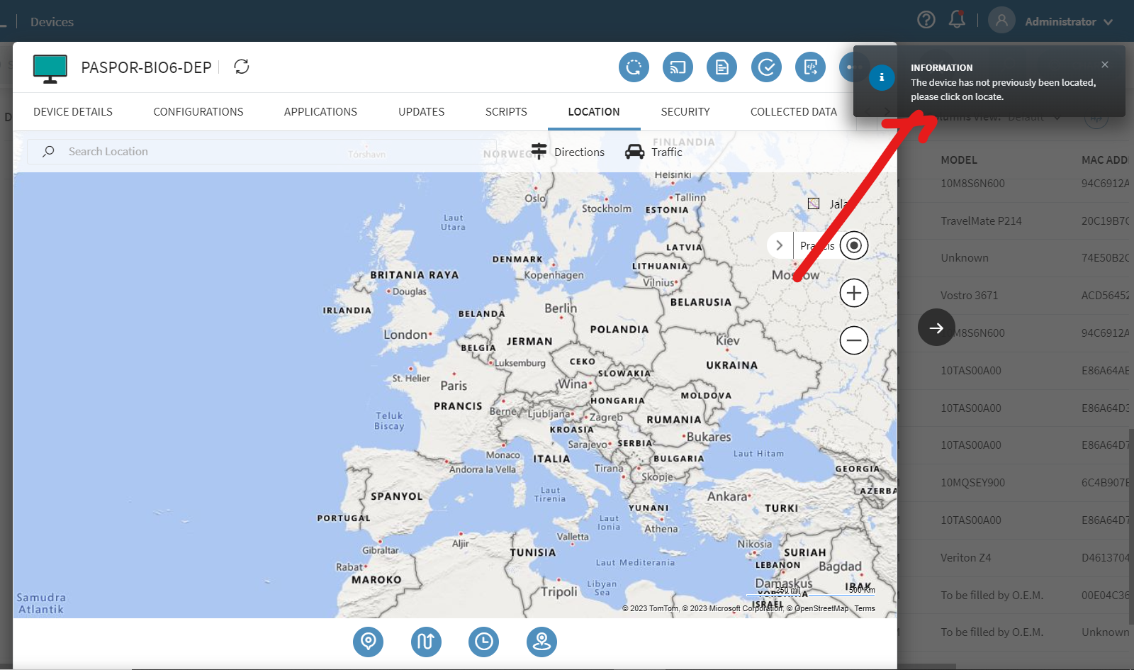

When I click locate, info like above always appears, even though I have added the collected location data.

Just to verify, so, you don't see any error similar to above, after you click on Locate and wait for a while?

yes, I also found such error

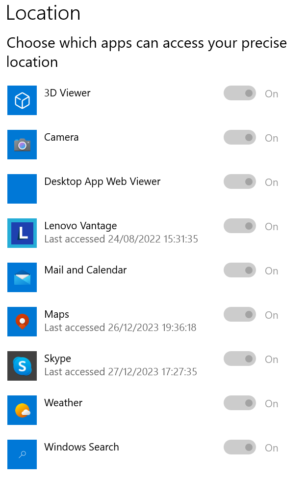

As above notification says, you may verify whether the location services is enabled on your test device, and SOTI MobiControl app can access the location. Below is an example for 3D Viewer app:

there is no option for soti mobicontrol

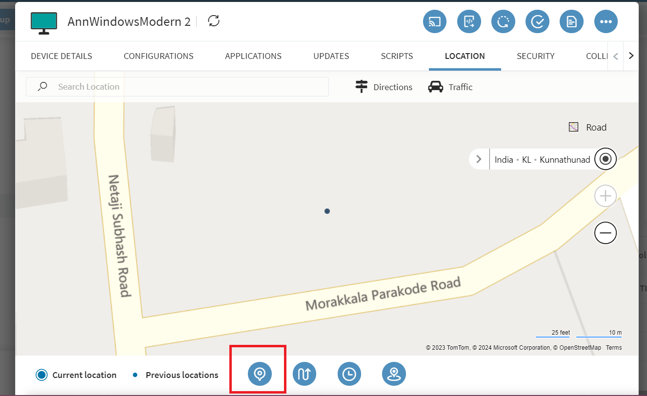

To collect location data, start by locating the device from the Location tab—click "Locate" at the bottom.
Please note that the device location will only be captured by the device agent and reported back to the server when the "locate" device action is requested via the location tab of the associated device in the web-console while the device is on-line.
 After locating the device, proceed to apply the data collection rule.

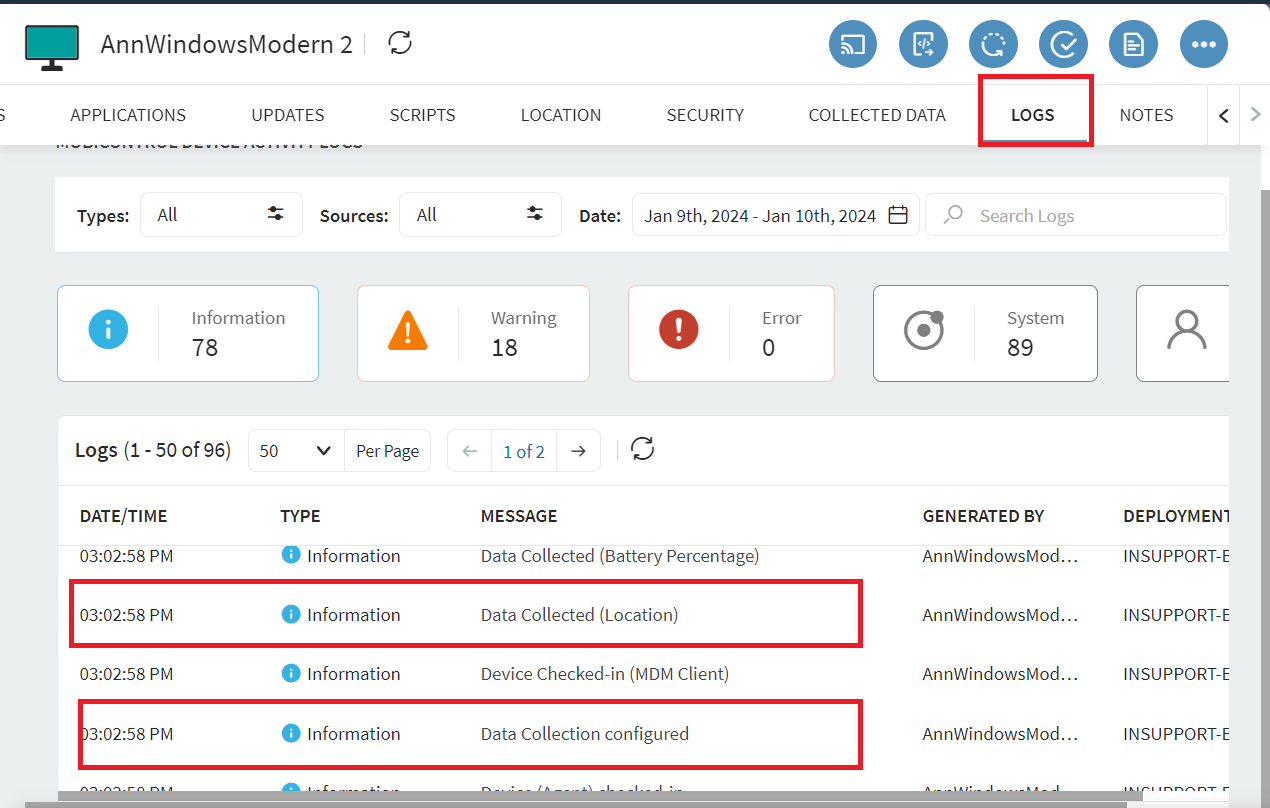

Then check under the collected data tab-->
Search for Location.
Ensure the device's location service is turned on. For further insights, refer to the Logs section, where you can review the collected data logs to confirm its proper functionality.
I hope this addresses your query. I am attaching screenshots for your reference.
