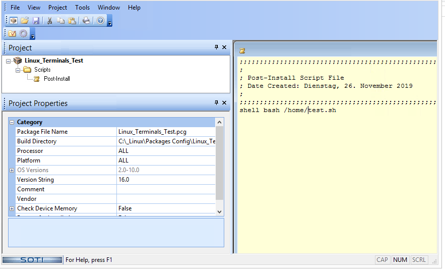

are you able to execute shell-commands with this script-command in a package?
I tried this script-command (PostInstall: shell test.sh), but it doesnt work for us.
We get the following error: sh: 1: ./sendScript.sh: Exec format error

i created the packages with two different versions of mobicontrol:
Package Studio 14.4.2 Build 308
Platform ALL
Processor ALL
Package Studio 14.2.0 Build 351
Platform Linux
Processor ALL
We use this sample-script for testing: reset /s
Regards, Sascha

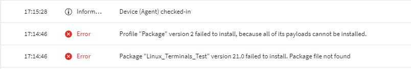

Test 1: PreInstall-Script (mkdir /home/SOTIinstallscriptTest/)
Error: Profile "Package" version 1 failed to install, because all of its payloads cannot be installed. Error: Package "Test" version 1.0 failed to install. Package file not found
Test 2: PostInstall-Script (mkdir /home/SOTIinstallscriptTest/)
Profile is installed, but the script was not executed (directory was not created).
Platform Linux
Processor ALL
Error: Profile "Package" version 3 failed to install, because all of its payloads cannot be installed. Error: Package "Test" version 3.0 failed to install. Package file not found
