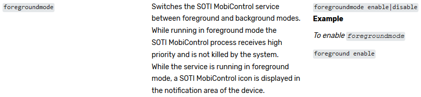

So apparently i missed something and you can somehow leverage foregroundmode via scripts:
Although i cant get it to work with DA and Agent 14.0.0.1579
Foregroundmode enable doesnt work
the example foreground enable doesnt work either
S
Scott
'foregroundmode enable' works for me in DA mode with agent version 14.0.0.1579.  An icon appears in the notification area:
(It doesn't appear to work in AEDO mode)
