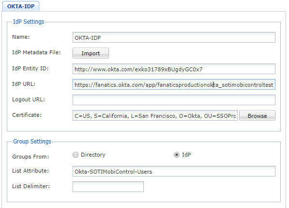

The data was initially imported with eh metadata file and the one thing that threw me off was the list attribute which I want sure what would be required for the field. I wasn't sure if that was the root cause but figured I would reach out here to see if anyone else had this before.

List Attribute was questionable

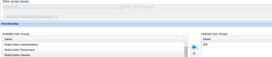

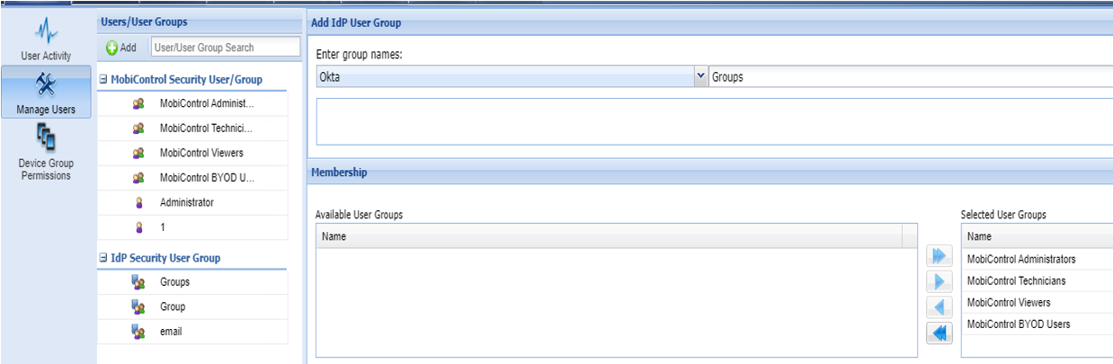

Did you add this group in User and Console Security section?
JM
Joe McKinney
I did yes
Even made a new group to go with it

Could be several things going on but for one thing, SAML string values are assumed to be case sensitive so your group name definitions should match exactly.  Your screenshot is showing all uppercase group definition but the name in the list box is not.
Having said that, those entities are not the same.  The List Attribute is not itself a group definition.  It is an attribute that will be returned by the IdP and it will contain one or more group names, separated by the character specified in List Delimiter.  Those values are what need to have matching MobiControl IdP group definitions.

I was able to make some progress with the configuration but I think the issue is really down to the list attributes and what should or shouldn't be assigned to the IdP and user groups.
Currently I am failing with the error Invalid SAML 2.0 message. Assertion validation failed.
Since the SSO connection is only done on the SP side and the IdP required that I fill in the list attribute I wasn't entirely sure as what should have been passed.
Reviewing some of the details that Scott has posted on https://discussions.soti.net/thread/sso-single-sign-on-fyi/ and knowing that it doesn't pass an encrypted assertion we cant simply load the certificates.
