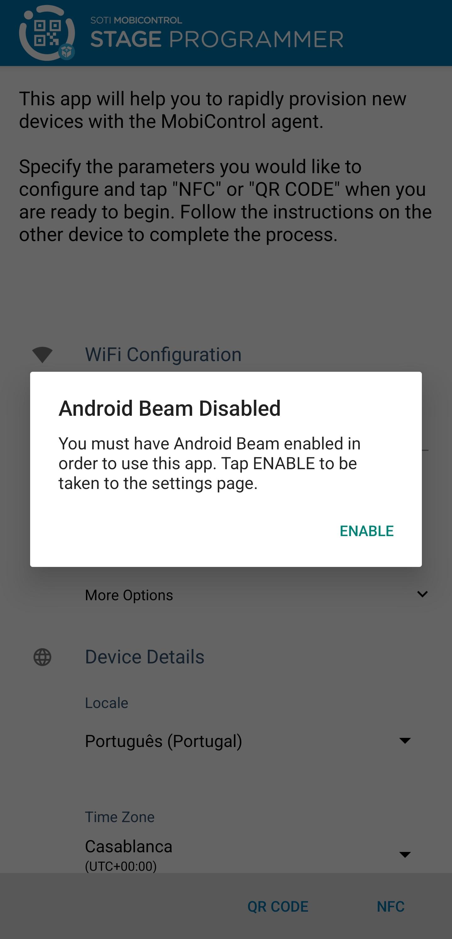

Hello Rafael,
Application shows this message, and when I click Enable nothing happens:

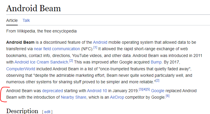

I search online and found information that Android Beam was deprecated since Android 10.
