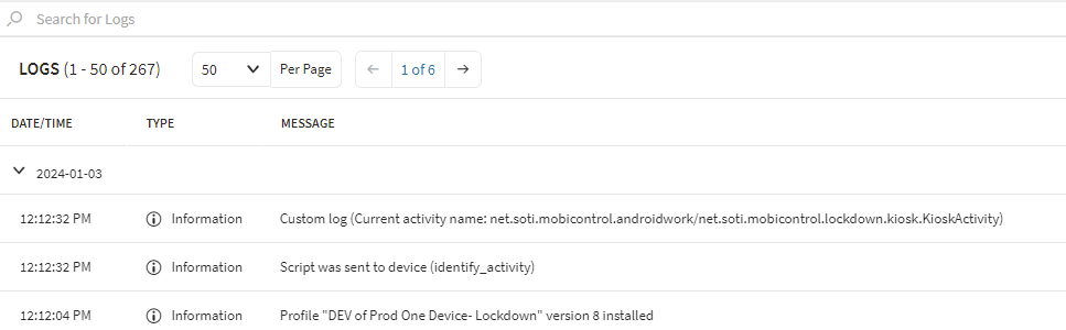

Ran the Identify_Activity script in admin mode while dialing out and got this package ID name: com.samsung.android.incallui/com.android.incallui.call.InCallActivity

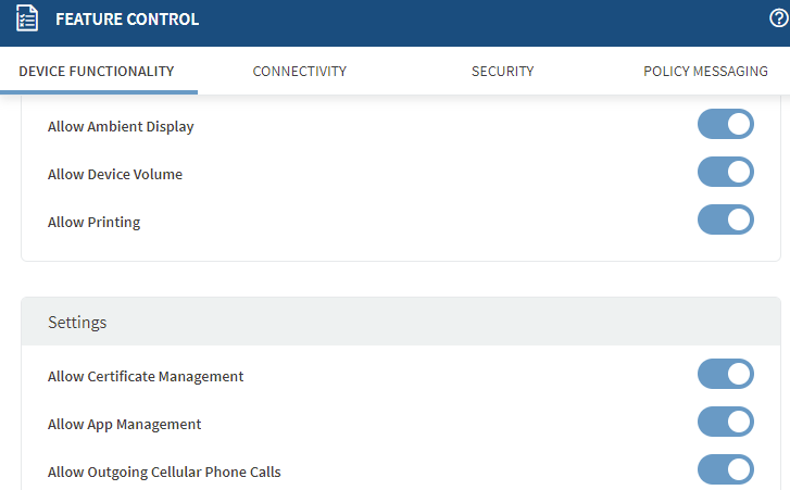

Could you please double-check if your profile has the "Feature-Control" payload with the "Allow Outgoing Cellular Phone Calls" option enabled?

Hi there, this is already turned on.

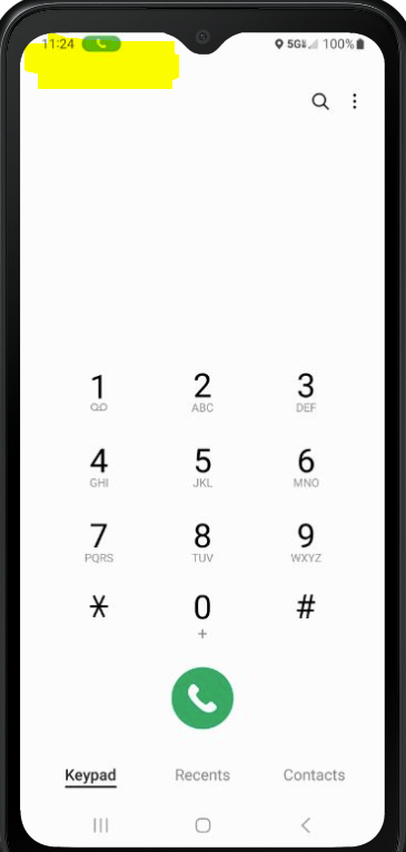

I can now get to the phone app but when i dial the number and press the call button nothing happens, just dissappears and never makes a call

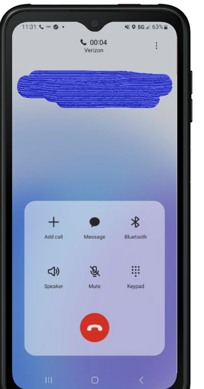

It will make calls now but the call is not shown in the window it only shows at the top in the notification bar and when i try to click on the screen while the call is in progress it flashes on and off, very weird stuff and not a solution for me to implement the native lockdown right now in my enviornment with the current behavior. but "it does make the call"

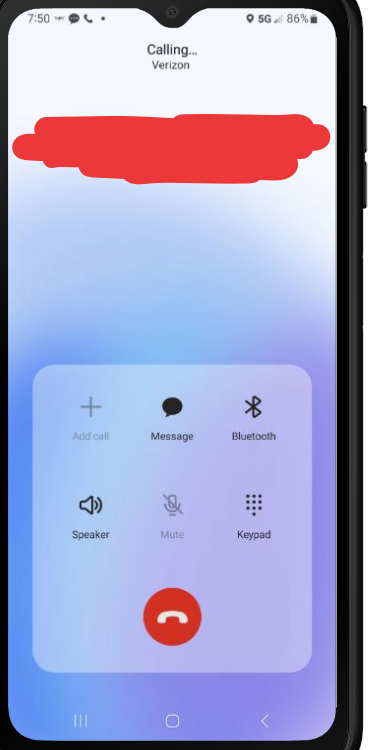

activity suppression lockdown when making the call looks as should:

As you have identified "com.samsung.android.incallui/com.android.incallui.call.InCallActivity", have you added this to the lockdown as well and tried again?
KW
Katie Williams
2 years ago
Thank you for saying that! I added that one back as well and did get it to look like it should! Did a little more testing with the others (didn't feel like I needed them all) and these are the only ones I need to get the call working in Native Lockdown Mode:
For phone app: com.samsung.android.dialer
For telecom service on android devices: com.android.server.telecom
Activity inside of the call: com.samsung.android.incallui/com.android.incallui.call.InCallActivity
Thanks so much to everyone who assisted me with this one. I have found a solution to use native lockdown template and be able to make phone calls!
