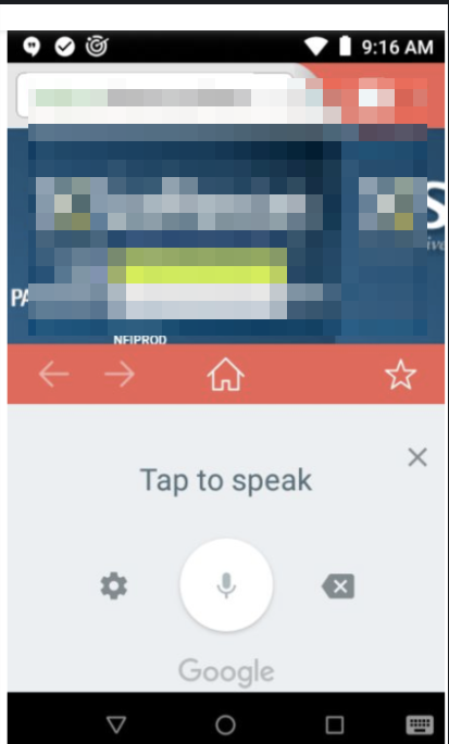

The result of this script is that Google Voice typing is the enabled keyboard - I am using ZEBRA TC75x Android OS 8.1.0, MX 8.2

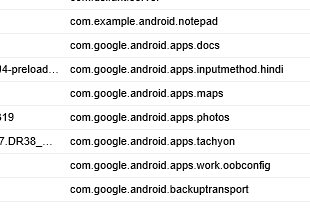

I use an App Blacklist to disable the Google Voice Keyboard
com.google.android.apps.googlevoice
K
Klaus
How do you blacklist the app?
Like this?
Yeah that is annoying.
KM
Kirsty Monk
I can't find Google Voice in my list of installed applications, any ideas on how to find it?
App Blacklist is one of the Profile options. You can manually add the bundle ID that I provided.

I've changed it back which disabled the GBoard but I still can not enable the enterprise keyboard and I am left with the Tap to Speak Keyboard.
