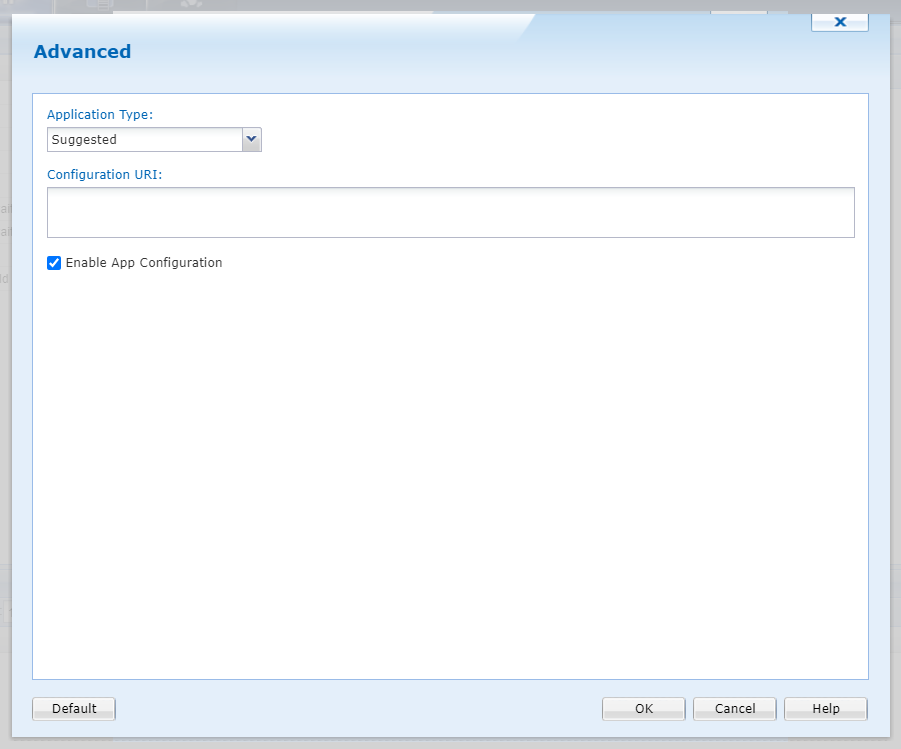

Edit: The advice given regarding Zebra OEMConfig is incorrect, please reference this screenshot directly from the "Enable App Configuration" checkbox as found via an App Catalog rule.
Currently, there is no method to achieve what you're looking for within MobiControl itself. It's also not possible via OEMConfig or Writesecuresettings script at this moment in time.

I've edited the solution post to include new information regarding Zebra OEMConfig, please let me know if you have any questions or need clarification. An additional thank you to Matt for highlighting the feature within the config.

Hi John,
its not available in Advance.
Application Catalog > MobiControl | Android Enterprise

JCMOD@SOTI
Hi Mifras,
I've attached a screenshot of the configuration according to the Application Catalog Entry. Can you confirm that you're using the "Zebra OEMConfig" app instead of MobiControl app?

Mifras
Zebra OEMConfig was not approved in my catalog. I just approved . Its fine i can see the option now
