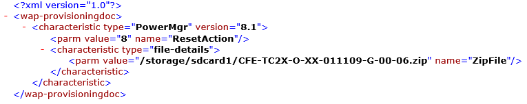

For a TC77 to Update from an extra sdcard i leveraged /storage/sdcard1/Update.zip in stagenow for example.

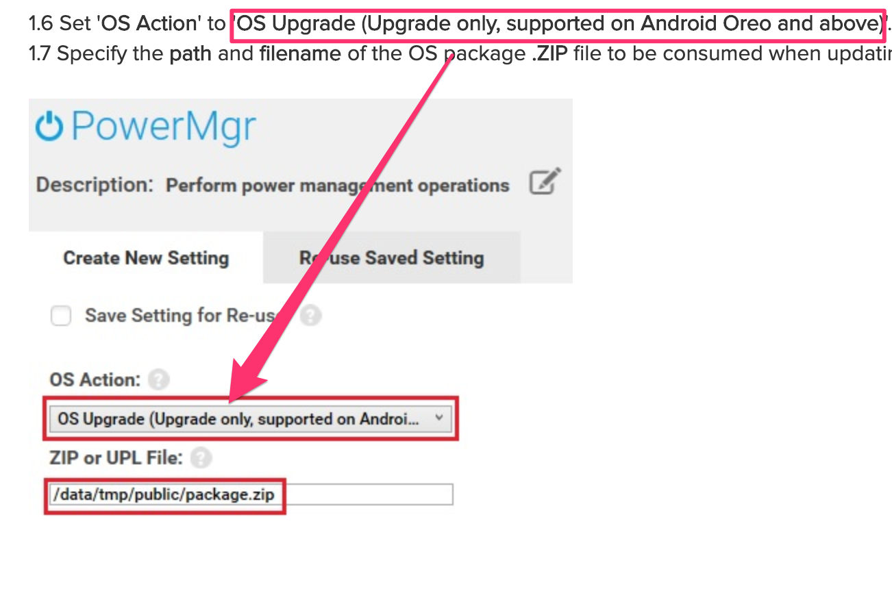

In looking through the StageNow options there is an explicit callout that downgrade isn't supported so I'm not sure if you're going to be able to find a SOTI script that does this:
