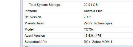

we have mobicontrol in version v 13 0 34 54
we used many zebra TC75X on android 7 with client mobicontrol on version 13 6 0 1476.
Each time we install an app the user need to ACCEPT permission ...
I would like to automate this, i've find in doc of mobicontrol the script for android + :
afw_set_permission_policy grant
I've include this inside the package builder (pre install script), add my apk inside.
add package inside a profile and add profile to a device.
But each time the permission appear on screen and user need to ACCEPT ...
If I look inside the log of mobicontrol i have this entry: Script command is not supported by device (afw_set_permission_grant_state)
Must i update the client or ?
Anyone can tell me how i can automate this because we have many device ?

Can you please confirm the enrollment type i.e. Android Plus or Android Enterprise?
The scripts you provided will not work on Android Plus devices as the 'afw' only works for Android Enterprise.

thanks for your reply, yes device is enrolled by android +
i've found the doc here ->
https://soti.net/mc/help/v14.3/en/scriptcmds/reference/androidplus.html
But i've try but not work ...
Or perhpas something i do it's not on the right way ...

You are using an OEM specfic Android+ agent rather than the generic Android-Enterprise device agent.  The script comand mentioned does not work on the former, and only works partially on the latter (based on some tests done about a year ago).  I myself am waiting for a more stable set of script commands for handling apps permissions on AE platform.
