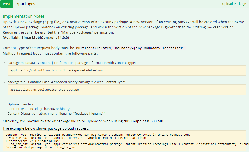

Has anyone managed to upload a package to MobiControl in any programming language? The API documentation is as below and I have tried to recreate the example file in the above lines. But I always get the same error: "Unexpected end of MIME multipart stream. MIME multipart message is not complete."
API POST Package
