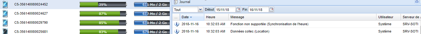

In the log, we have the message ''function not supported (time syncronization''. Do you know why please ?
8 years ago
Are your devices using Android+ or Android Enterprise device agent?  Time synchronization is currently not supported in the latter platform.

The device is the C-five from Coppernic (Android +)
I also encountered some smaller OEM brands which do not support time-synchronization in their Android+ device agents, possibly because the OEM managements don't want to invest their engineering resources to modify their firmware to change system date/time when the device agent receives such change request from the MobiControl server.   There is nothing an end customer or Soti can do.
Are you actually from Coppernic that owns the C-five devices?  If so,  check with your colleague coordinating Android+ device agent development/certification, and see if there is a need to implement such feature in an updated version of the device agent.  According to what I know,  the codes on Soti side are always ready.  Whether or not a feature is there depends solely on whether the OEM development team have the resource/time to modify the device firmware to support the needed function.
