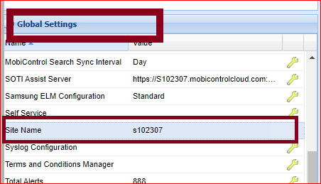

These queued scripts stored in the database. You can view these pending scripts in the Shared File Browser in the webconsole as mentioned in the path below and one can delete these scripts if not needed. Please refer to the steps below to access and delete scripts in shared file browser.
  • Go to Global Settings
  • Navigate to Sitename , Launch "Shared file Browser" by SHIFT + CTRL + CLICK .

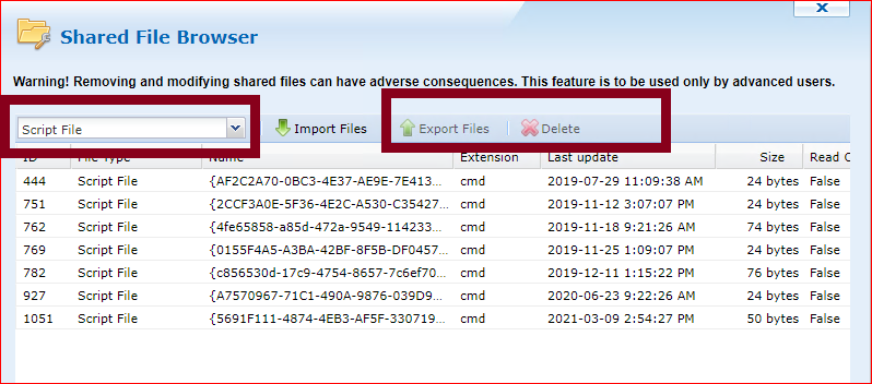

  • Select File type as Script file.
  • You will able to see all the queued scripts there, Export the CMD file according to the Last update.
  • Open the CMD file in Notepad ++ and delete the script from the shared file browser if not needed.

Is there a way to know which file goes with which devices?
