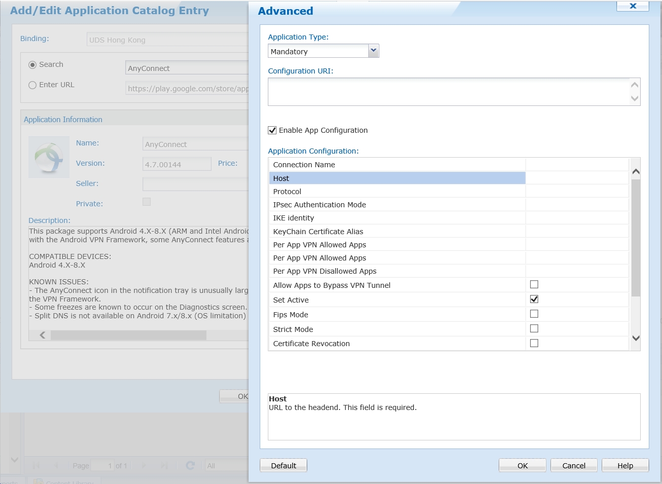

While I personally haven't got involved deeply with customers using Cisco AnyConnect VPN on Android Enterprise platform,   I think it is worthwhile for you to know the following:
1. Just like most other VPN client apps from top VPN vendors, the Cisco AnyConnect client app from managed Google Play store (at https://play.google.com/work/apps/details?id=com.cisco.anyconnect.vpn.android.avf) supports AppConfig configuration.  In other words,  configurations are set in the advanced configuration tab of the app item in your App-Catalog rule (see screenshot below) rather than set in a VPN profile.
You have to check if the parameters configurable are sufficient for your use, and the app is compatible with your MobiControl server and AnyConnect software.
2. If your existing devices are to be switched from Android+ to Android Enterprise platform, the migration cannot be securely done over-the-air.  It is best that all devices be recalled because a device factory reset is required.   The existing Android+ agent should be unenrolled/deleted.  Then the device should be factory reset, and then enrolled to Android Enterprise platform (via afw#mobicontrol tag, QR code, NFC bump, etc.) to force it into Managed-Device Mode.  The VPN client app, together with the required VPN configurations, can then be pushed over-the-air onto the device by MobiControl.  You have to create and deploy Android-Enterprise profile(s) that cover as much as possible the policies originally defined by your original Android Plus profiles.

Thank you Raymond. Forgot all about the app config in the Play Store for Work.
