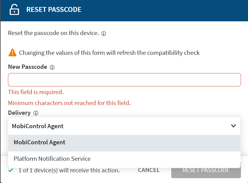

To remotely change the PIN on your Zebra TCXX devices, even when they're offline, use Soti MobiControl's "Reset Passcode" feature.
When resetting the PIN, select "Platform Notification Service" as the delivery method. This allows the new PIN to be sent directly to the device, bypassing the need for it to be online or unlocked.

This does not work.  The Soti MobiControl agent on the device does not start up until the user enters their PIN.  In this scenario, I forgot my PIN so I cannot enter the device, the Soti MobiControl agent never starts after boot up.  So, the device never gets the Reset Password command.
This in my issue.  Every time a user forgets their PIN and the device is rebooted, battery swapped, power dies, etc., there is no way to access it once it boots up.
Android 13 does not allow any type of remote access to the device until the user physically enters the PIN.

When resetting the PIN, select "Platform Notification Service" as the delivery method. This allows the new PIN to be sent directly to the device, not through device agent. So the device don't needs to be connected for this action.

This does not work.  Nothing is running on the device until the PIN is entered.  The device gets the password reset AFTER the old password/PIN is entered and the device boots up.
