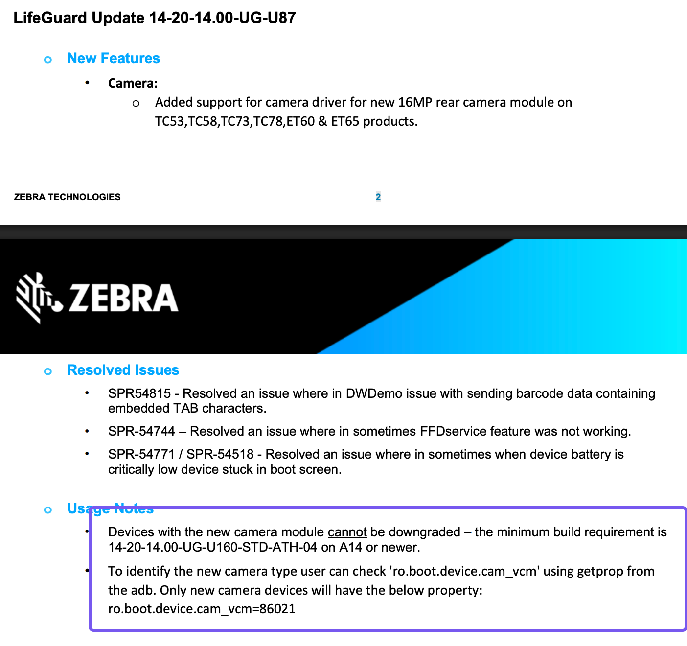

The process looks good from my end.
Sometimes downgrades are not possible however in situations where a new physical component has been sourced. For example this recent A14 OS for the TC58 indicates that there is a new camera component that will prevent downgrades.
KN
Kjetil Nordby
a year ago
Thanks, Matt
This explains why I can't downgrade from OS14.
I dont have the device fysicly With me, do you know a way to check camera type remotly?
Br. Kjetil
a year ago
If the devices shipped with 14-20 U160 you can probably assume as much.
To remotely verify the adb getprop you might be able to see that info in the snapshot logs from Rxlogger.

I had a meeting with Zebra and they told me that the latest LifeGuard 13-39-18.00-TG-U00-STD-ATH-04 to TC53 have suport for camera driver.
I have tested to downgrade from Android 14 to Android 13 with this and for me it works.
I used downgrade .xml from StageNow.
Case is solved.
