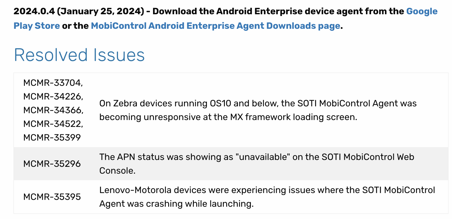

I have not had that particular issue reported yet but I'm guessing it's only a matter of time. The release notes for that agent had a specific fix for the MX framework so it is very likely you seeing that fix in action.

It's not just an Android 10 issue. I'm seeing this on MC93, and to a lesser extent VC8300, devices running Android 11 at boot. Both are running the latest agent version 2024.0.4.1056.
