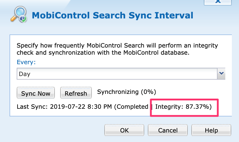

Also check your Search Sync Integrity, you may have to manually sync.

Where is this located? The system Admin has me locked out of some things and I have never seen that screen.
Found it. Is set at Day. Integrity is 100% Attempted Manual refresh.
100% Integrity should be good. Keep in mind that version 14 introduced the quick filter device inventory view that also introduced a separate stats db of sorts that is synced off of the primary db so that it can be quickly queried against without affecting the performance of that primary db. It seems that this synchronization tends to drift at times so you may observe different properties reported for a particular device in the inventory view than are actually technically reported from the device at the same time. The manual sync can clear up those discrepancies but it can otherwise be pretty frustrating.
