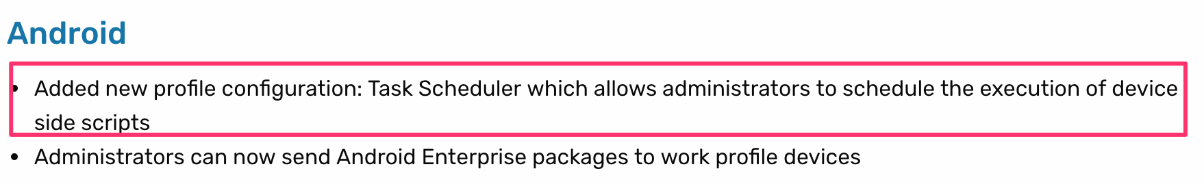

14.3 just finally introduced the ability to run scheduled Scripts:
Preliminary tests on v14.3 server show that this first implementation is basically OK.  However, there are at least the following shortcomings:
- Like file-sync rule schedule or update schedule in advanced setting, the time schedule for script execution is restricted to be 0/15/30/45 minutes past any hour of device/UTC time in the web-console UI.  This is unacceptable because unlike the other schedules, which involve deployment server that can be busy serving many tens/hundreds of devices during the same minute so that larger time jitter should be tolerated, scheduled script is pre-pushed to be run on target device and a much lower jitter should be achievable.  Thus administrator should be allowed to specify any time down to minute or even second accuracy.
-  There are no option(s) to specify script priority and maximum delay (after the specified scheduled time) after which script execution should be cancelled altogether.  These help to handle cases in which the device is powered off, or busy working on some other tasks/scripts or higher priority, or in deep sleep during the scheduled time.
