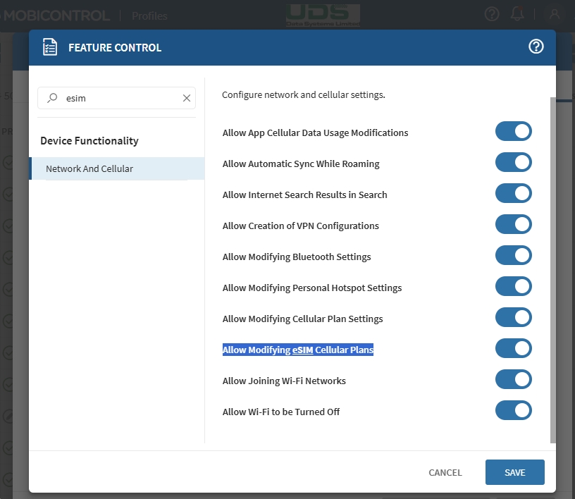

eSIM can be automatically installed on an iPhone (with iOS 16 or later) or iPad (with iPadOS 16.1 or later)  during device setup using Automated Device Enrollment with  Apple Business Manager.
Go to  https://support.apple.com/en-us/101569  to find wireless carriers and worldwide service providers that offer eSIM service on iPhone.
11 months ago (edited 11 months ago)
Recent Soti MobiControl versions already includes
  • "Allow Modifying eSIM Cellular Plans" option in iOS/iPADOS restrictions profile
  • Support for other eSIM restrictions such as restricting eSIM transfer for iOS18/iPadOS18 devices, preventing deletion of eSIM on supervised device, etc. with  Apple Custom-Profile using .xml
  • "Preserve Data Plan option"  for Remote Wipe device-action of Apple devices
  • Update eSIM Cellcular Plan device-action.
