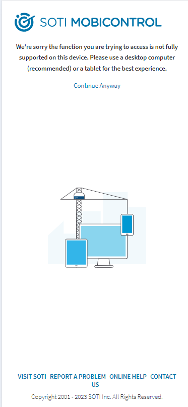

  • When configuring SOTI Identity for enrollment authentication on the SOTI MobiControl console and having Azure AD configured as third part IDP on SOTI Identity, the enrollment is failing with the below error:
SOTI MobiControl warning message stating that the function is not fully supported on the current device.

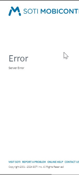

  • Similarly, suppose the setup is used for shared device configuration. In that case, the login process for the shared device fails with an error message when the user tries to access the login page from the agent instead of a successful authentication.

When trying to enroll a device or to login into a shared device, instead of the successful completion of the authentication process, the user is presented with errors such as follows:
  • SOTI MobiControl warning message stating that the function is not fully supported on the current device.
  • SOTI MobiControl server error message.
