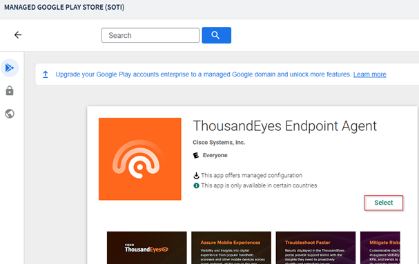

5. Select Managed Google Play Apps as the source.
6. Select + (Add) to search for and select the ThousandEyes Endpoint Agent.

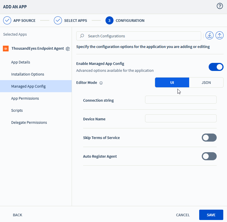

Part 2: Configure the Agent Using AppConfig
1. After adding the app, configure the app by selecting the three-dot menu, then select Configure to navigate to the Managed App Config tab.
    • Important: If you want the app to be installed immediately when the app policy is assigned, make sure to navigate to Installation Options and change the priority from default to High Priority. When set to default, the app installs when a device connects to Wi-Fi, is charging, and is idle.
2. Paste your connection string in the connection field.
3. Alternatively, switch to the JSON view to paste the following JSON, replacing YOUR_CONNECTION_STRING with your ThousandEyes account connection string:
  "connection_string": "YOUR_CONNECTION_STRING",
  "skip_terms_of_service": true,
  "device_name": "{{SerialNumber}}",
  "auto_register_agent": true
4. Save and assign the app policy and its configuration to your target devices.

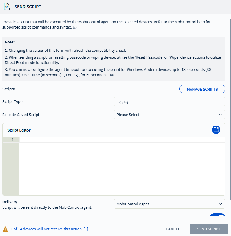

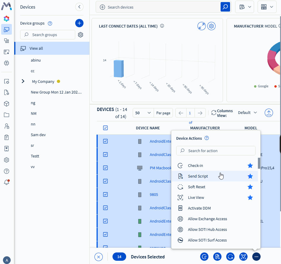

1. In the SOTI MobiControl web console Devices view, select your target device/ device group and choose the send script action.
2. Select Legacy as the script type.
3. Enter the following command to grant phone permission:
afw_set_permission_grant_state com.thousandeyes.endpointagent android.permission.READ_PHONE_STATE allow
afw_set_permission_grant_state com.thousandeyes.endpointagent android.permission.ACCESS_BACKGROUND_LOCATION allow
afw_set_permission_grant_state com.thousandeyes.endpointagent android.permission.ACCESS_FINE_LOCATION allow
afw_set_permission_grant_state com.thousandeyes.endpointagent android.permission.ACCESS_COARSE_LOCATION allow
4. Select Send Script to deploy the script to the same device group as the app policy.
