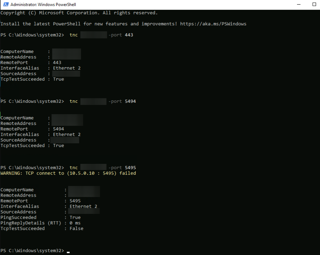

To verify the inbound connectivity of these ports using the Test-NetConnection cmdlet:
1. Connect the laptop/desktop on the network from where connectivity to the SOTI MobiControl server needs to be checked.

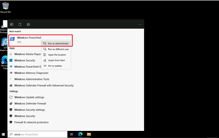

2. On the same machine, launch Windows PowerShell as an administrator.
3. Use the below PowerShell script.
tnc <localIP/FQDN> -port 443
Note:  you can use TCP port 443 with the local IP/FQDN (Fully Qualified Domain Name) for unrestricted communication between your SOTI MobiControl deployment and the SOTI data center.

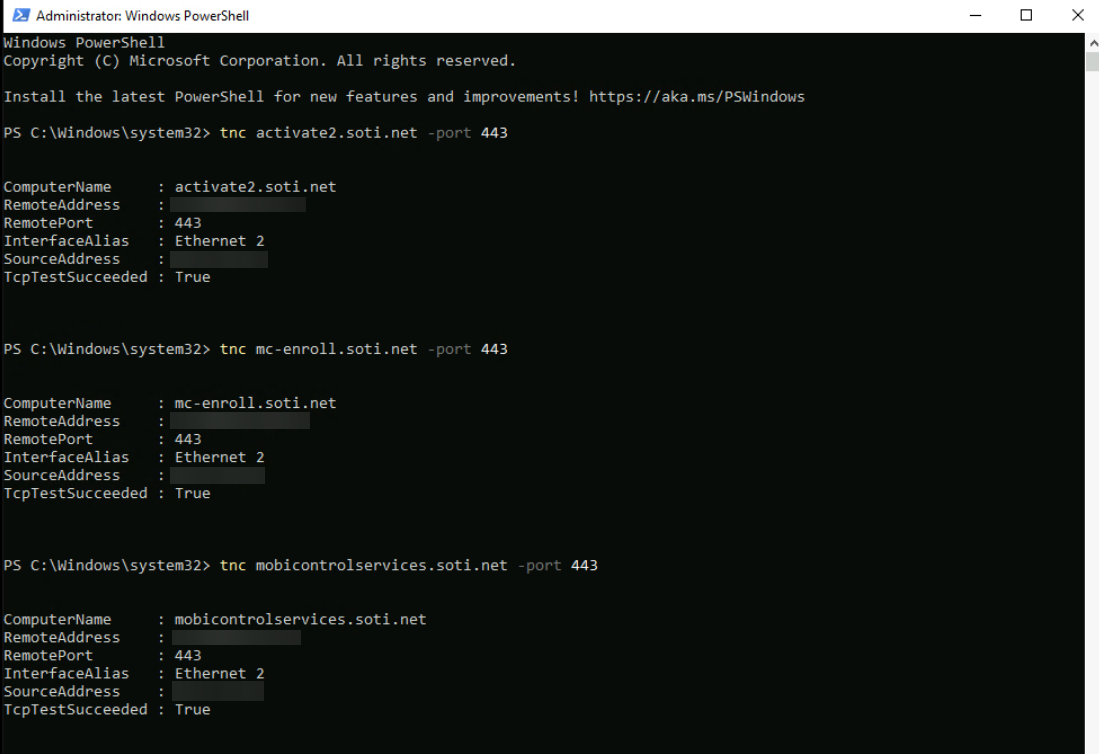

4. Use the following PowerShell script to verify the reachability of the services from the Windows server:
tnc <service URL> -port 443

    The Test-NetConnection cmdlet returns a boolean value (True or False) based on whether the TCP connection test is successful or not:
      • True: Indicates that the TCP connection was successful. The target host and port are reachable, and communication is possible.
      • False: Indicates that the TCP connection test failed. The target host and port are not reachable, and communication is not possible.
