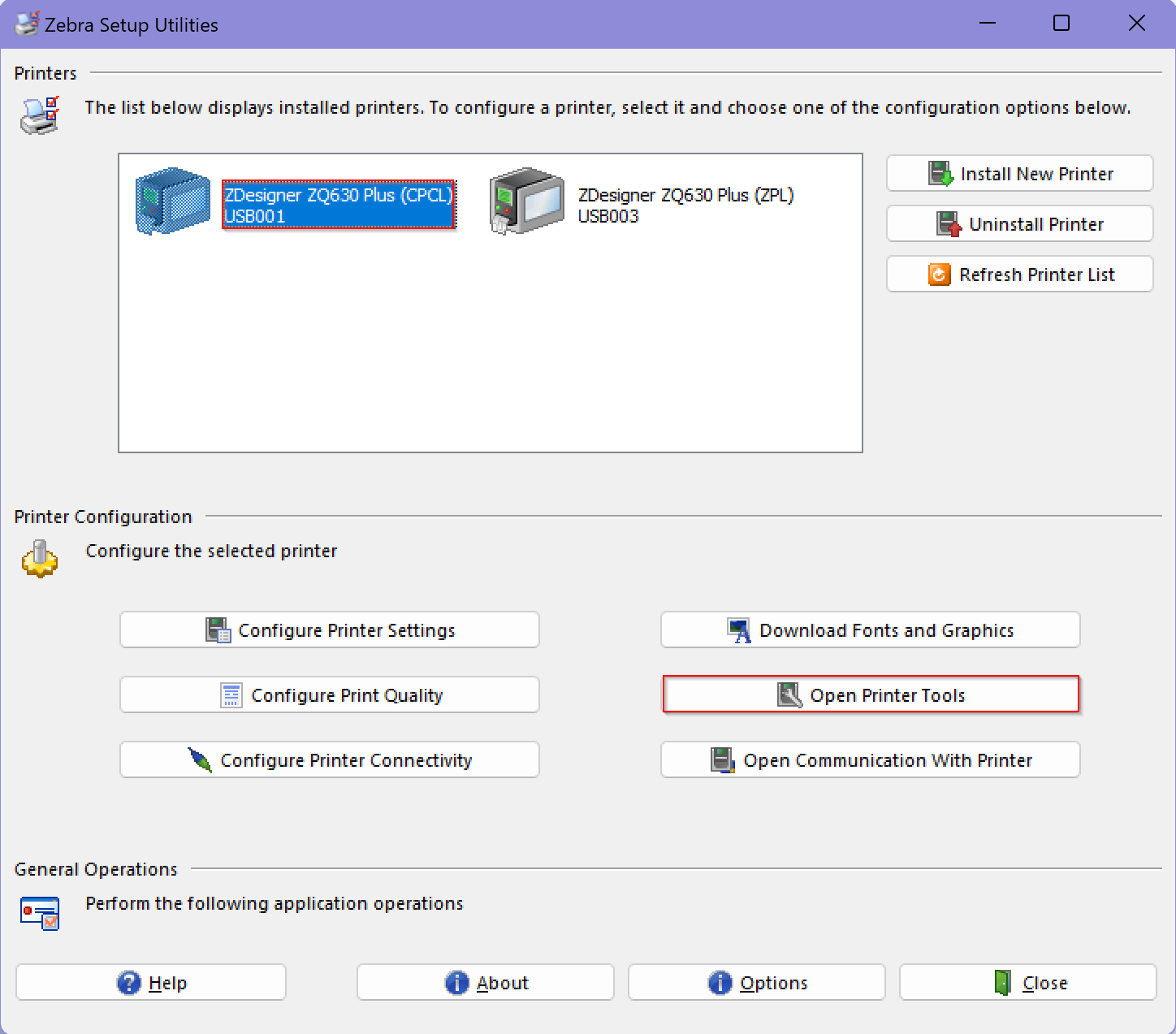

2. Launch the Zebra Setup Utilities application. It can be downloaded from:
https://www.zebra.com/ap/en/support-downloads/software/printer-software/printer-setup-utilities.html

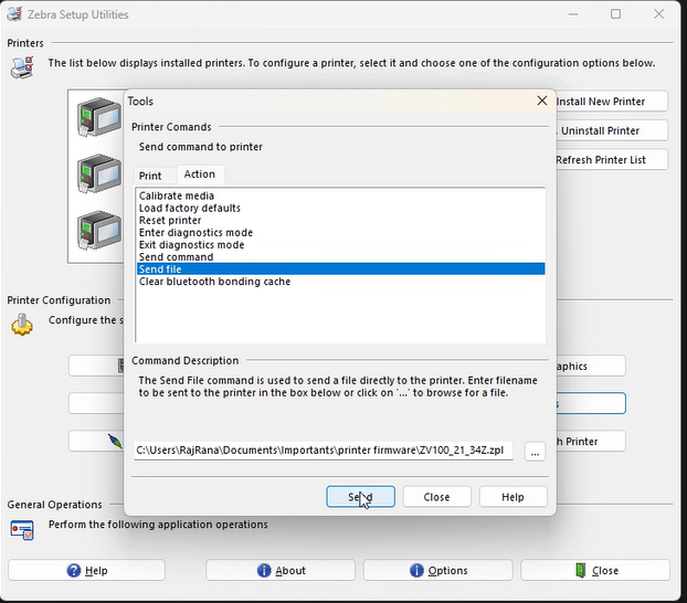

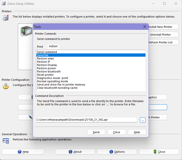

3.  Go to Open Printer Tools > Action > Send file.
4.  Select the firmware image file.
5. Send this file to the device:

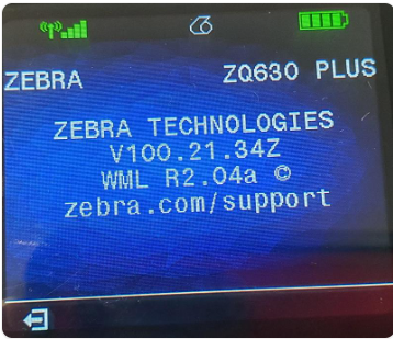

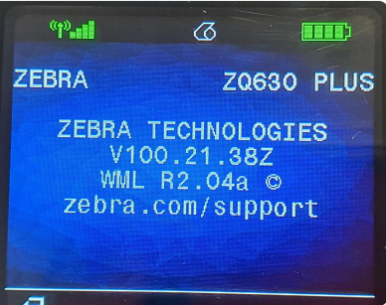

6. The Printer will restart and have a notification "Downloading image" on the screen.
Screenshot of the original firmware version v100.21.38Z
Screenshot of the firmware version, after it was  downgraded to v100.21.34Z
