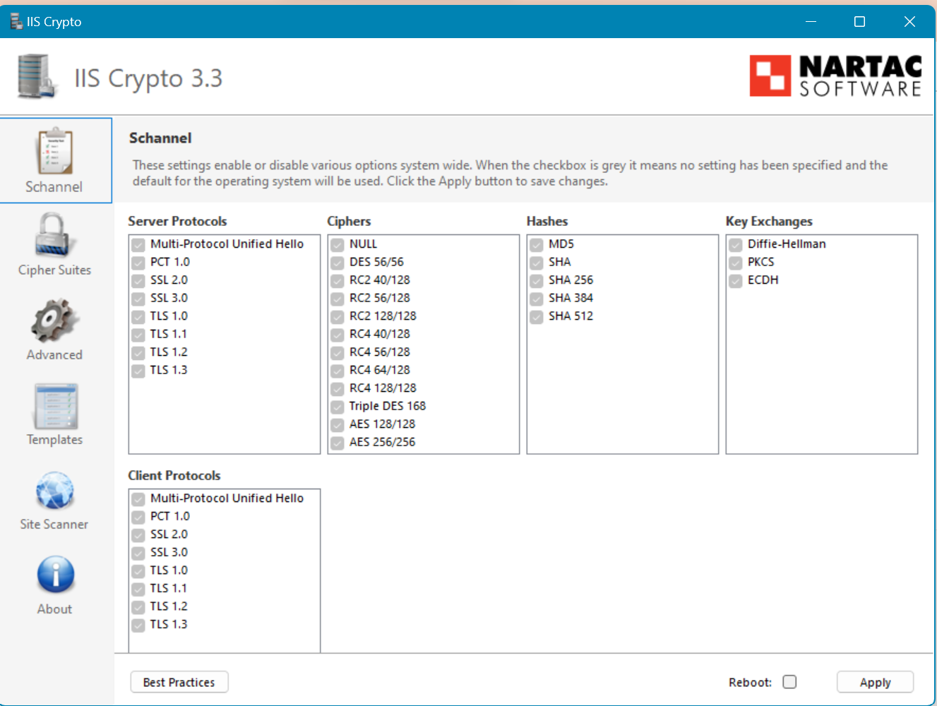

1. Download IIS Crypto GUI from https://www.nartac.com/Products/IISCrypto/Download on both the server and the Windows 7 device.
2. On the server, check the highest version of TLS enabled.
The IIS Crypto tool
3. On the client Windows 7, run the IIS Crypto and check if the TLS matches the server version.
4. Enable the TLS version corresponding to the one on the SOTI MobiControl server.
5. The action will require a device reboot. Perform a reboot on the Windows 7 device.
6. After performing the above steps, uninstall the Device Agent from the Windows 7 device and run the SOTI MobiControl Agent again.
7. The Agent should show as the connected status.
