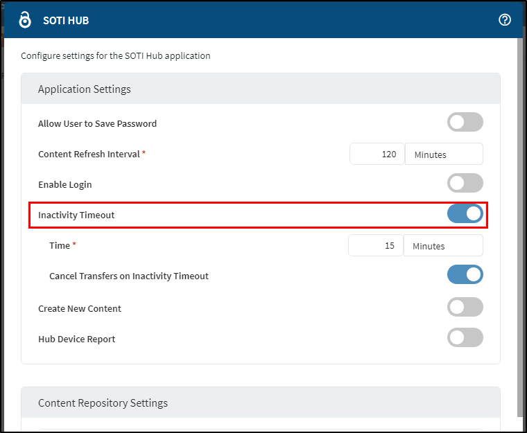

7. Under Application Settings, disable Inactivity Timeout.
8. Click Save.
9. At this point, an error will display on the web console and any changes to that profile will not be saved:
ERROR: An error occurred (likely a configuration or package validation error) when creating the profile.
An error message.

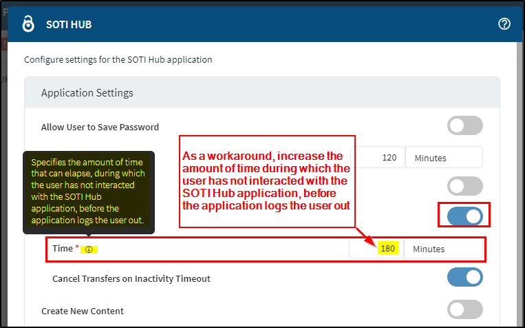

10. Enable Inactivity Timeout and increase the Time to a higher value as shown below:
SOTI Hub configuration settings.
Changing the inactivity timeout value to 180 minutes.
Note: Upgrade to SOTI MobiControl 2024.1.0 and above for a resolution.
