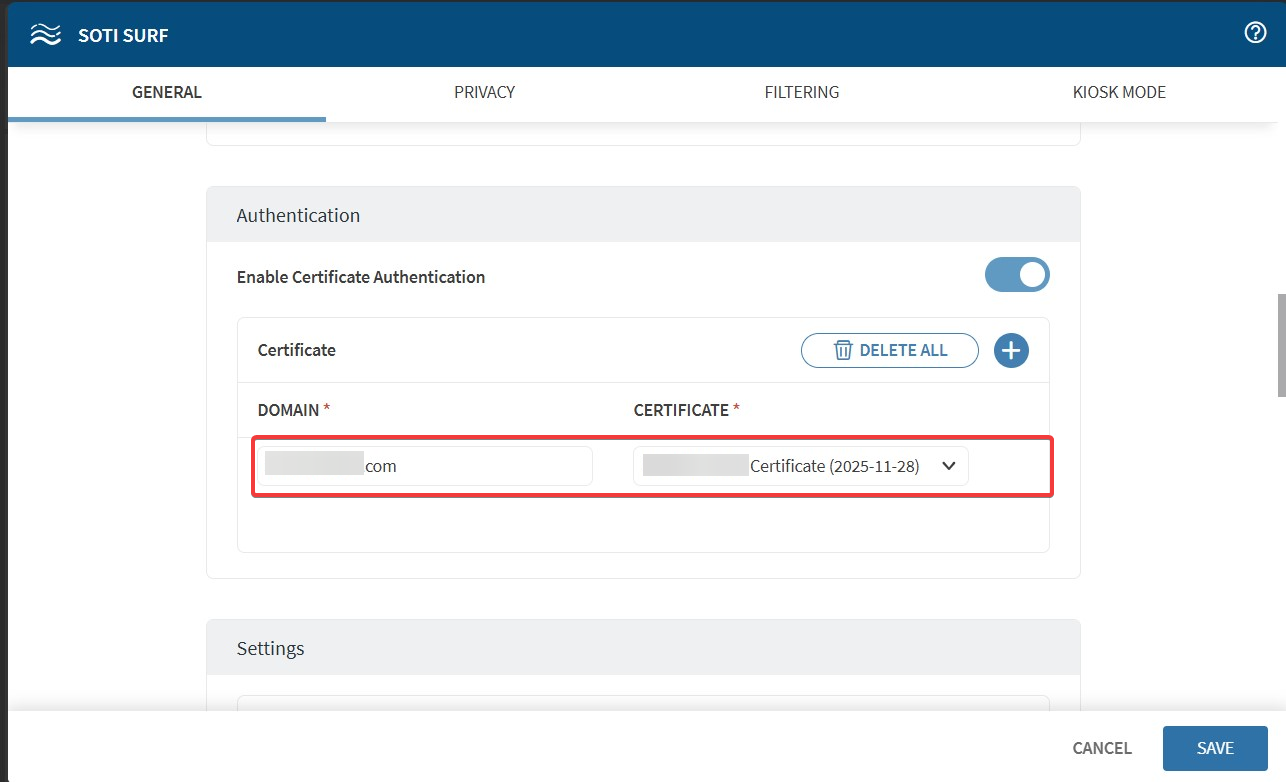

The configuration below can be sent in one profile with the Certificate and SOTI Surf  payload or can be sent separately.
1. Create a Configuration Profile: Include the following payloads in the profile:
    a. Certificate Payload:
           Ensure the required security certificates are configured for authentication.
certificate upload

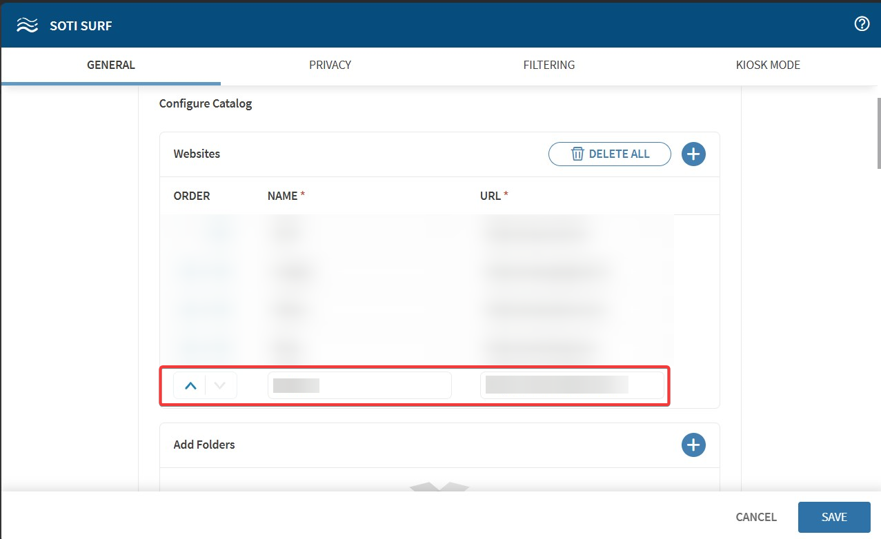

    b. SOTI Surf Payload:
           Add the designated URL under the "Configure Catalog" section.
configure catalog
           Enable the Certification Authority to support certificate-based authentication. Define the authentication mechanism for secure access.
certificate authority
