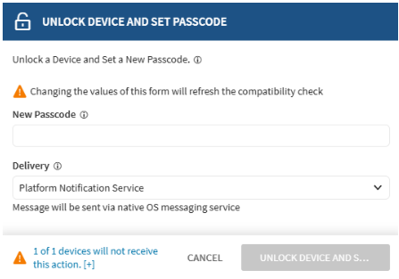

Unlock Device and set Passcode (SOTI MobiControl version 2025.0 and later)
The Unlock Device and Set Passcode action sets a new passcode for the device and unlocks it immediately. After selecting this action, you are prompted to enter the new passcode.
  • To unlock the device without changing the passcode, enter the current passcode.
  • To remove the passcode, leave the field blank.
The new passcode must comply with the authentication requirements in your payload. If it does not, the new passcode will not be applied. If the device is in direct boot mode, set the delivery method to Platform Notification Service. The notification may take a few minutes to reach the device.
Screen titled "Unlock Device and Set Passcode" with fields for a new passcode and delivery method. Includes a compatibility warning and note: "1 of 1 devices will not receive this action." Cancel and unlock buttons are at the bottom.
