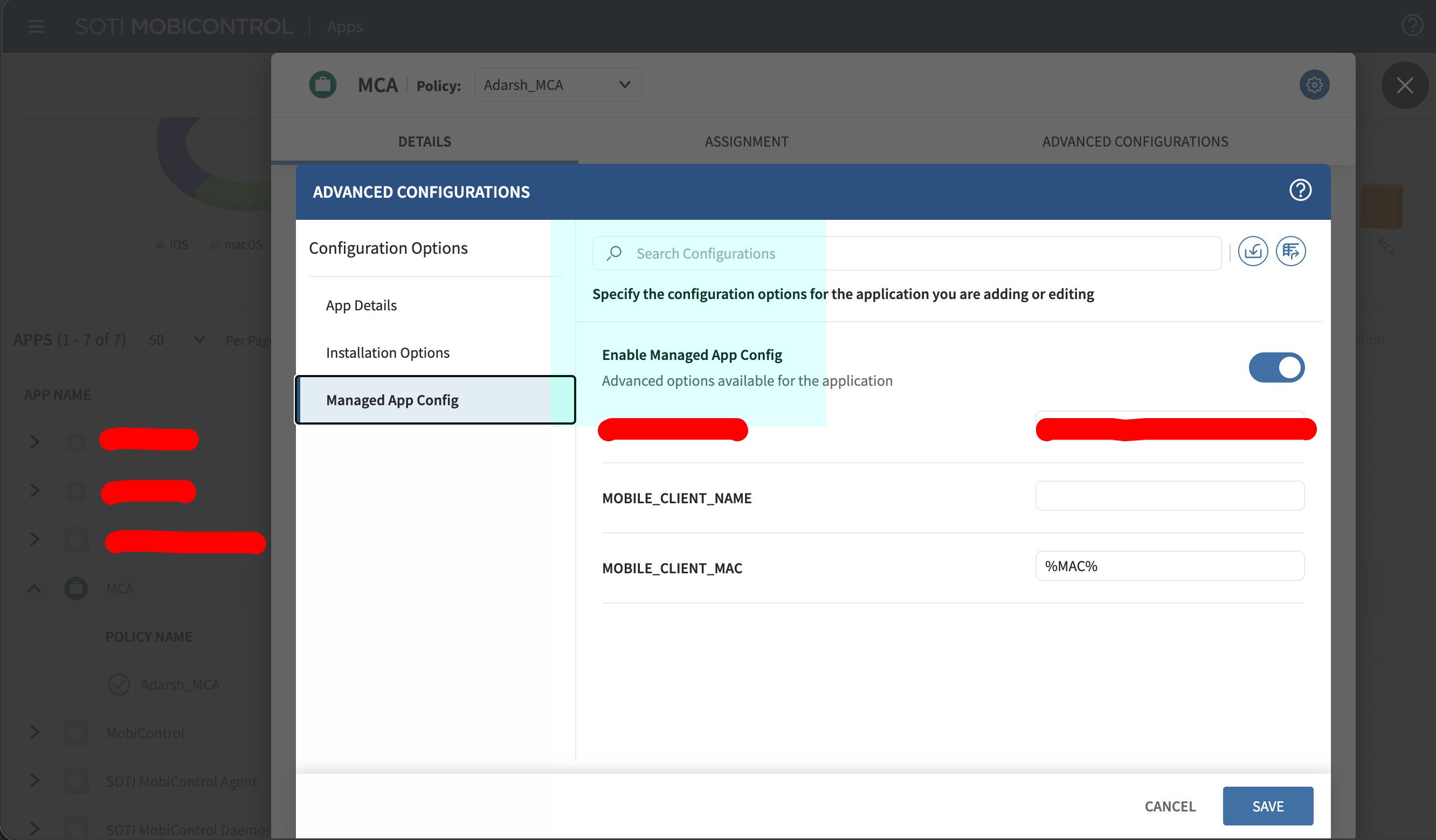

We (well, my colleagues) finally attempted to make use of it 2 years later, but it seems the %MAC% injection isn't working. Did we miss something? The deployment acts as if nothing was passed in. This was for enterprise fully managed Android device enrolled in SOTI and not a BYOD Android work profile case. We tested using the Managed App Config to define parameters to be passed as well as passing via RunIntent post-install script command. We're using SOTI mobicontrol dashboard version: 2025.0.0.1032.
My colleague tells me, if we hardcode a value for the MAC variable we've defined instead of using %MAC%, the value gets passed in, but using %MAC% we get nothing.
Attaching screenshots for reference. On a related note, we tested the equivalent feature on AirWatch / Workspace ONE, and we were able to get the MAC passed using their injection macro. We're trying to confirm same functionality with SOTI.

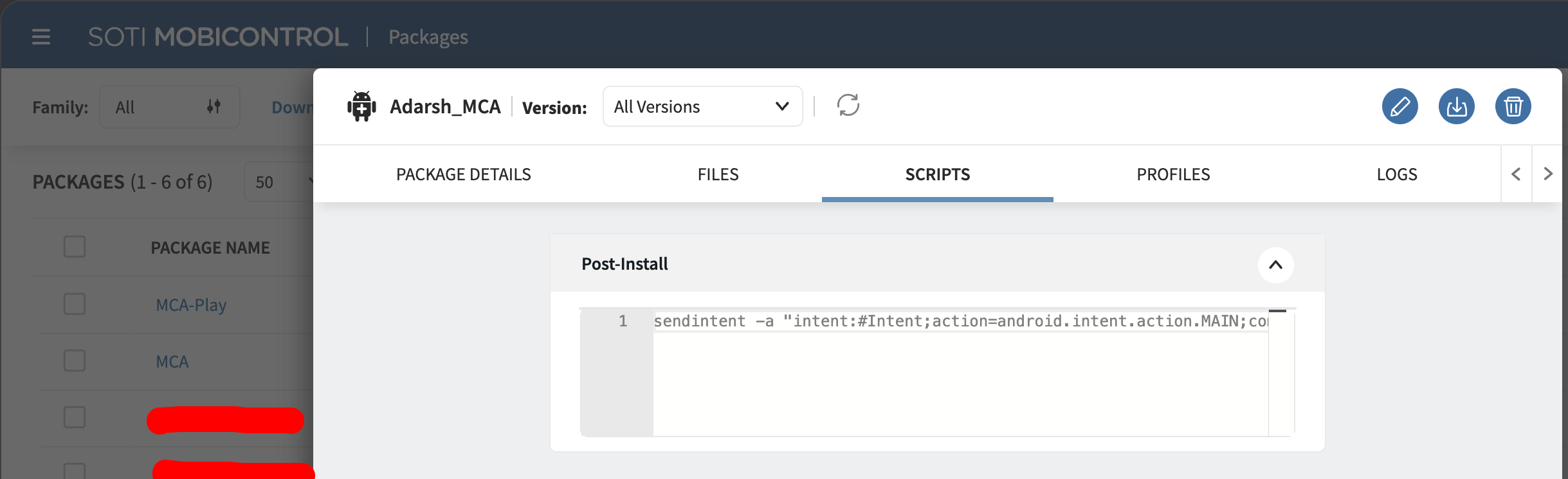

For RunIntent, our command looks something like:
sendintent -a "intent:#Intent;action=android.intent.action.MAIN;component=com.our.package/.MainActivity;S.SOME_PARAM1=some_value;S.MOBILE_CLIENT_MAC=%MAC%;end;"
Managed App Config for client MAC address
PostInstall RunIntent for client MAC address
