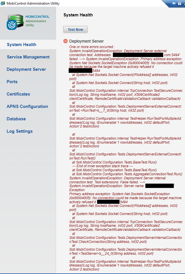

I did a fresh install using MobiControl1502Setup_1049_release on a server with Windows Server 2016.
In configuration I changed the https port from 443 to 444.
The Deploy Management Server is not starting, running System Health I have the attached errors.

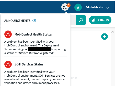

Also in the web console I have errors messages.

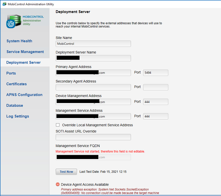

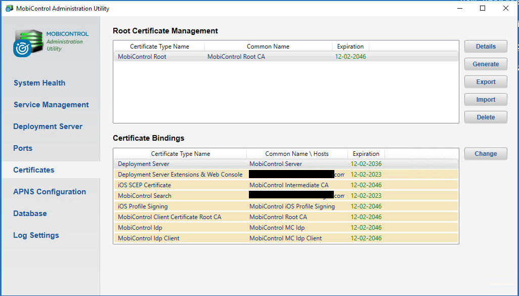

thanks for help, the web console and the certificates are working using 444 port, only the Deployment server is not working.
