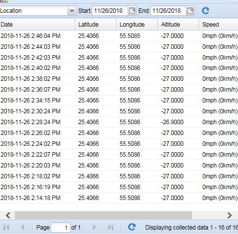

i have created data collection rule for location . and location is coming also .
now device is out side the geo fence i selected . but Alert is not getting generated
Your screenshot only shows collected data for a essentially stationary device for about half an hour only (actually before the time the genfence alert rule is enable, but no data after)?   Did your collected data cover the time period when your device cross the geofence?
Did you set your alert rule for geofence-entry, genfence-exit or both?  Was the device inside or outside the geofence when you activated both rules?   Do you know the approximate time the device entered or exit the geofence?
No i implemented it just now when u suggested

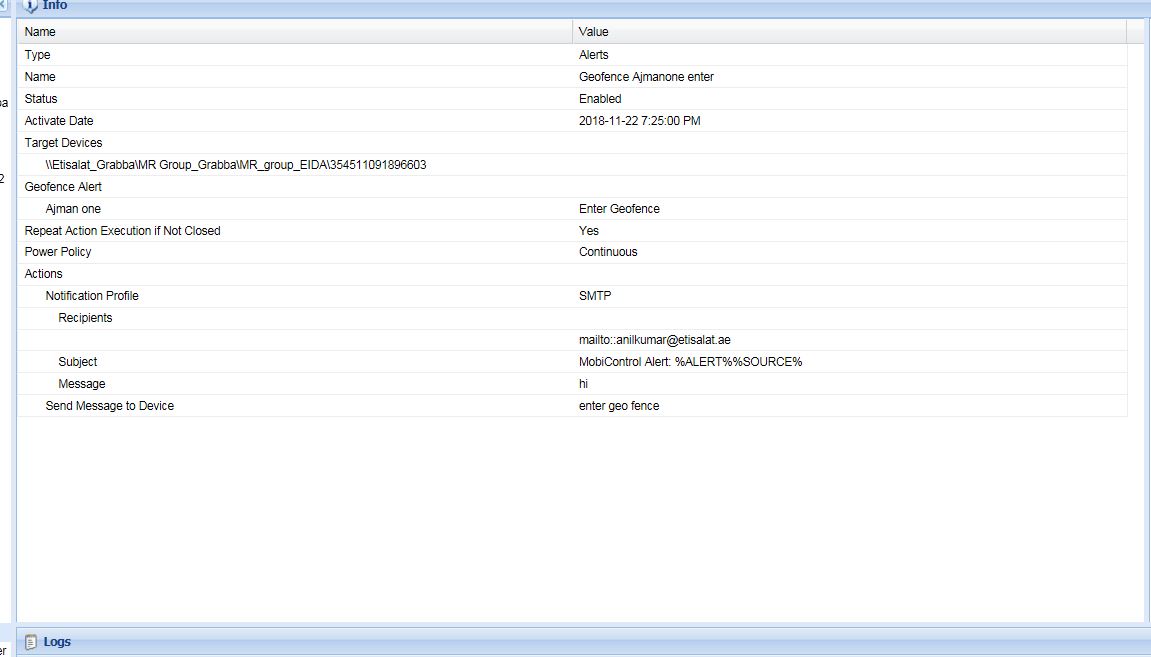

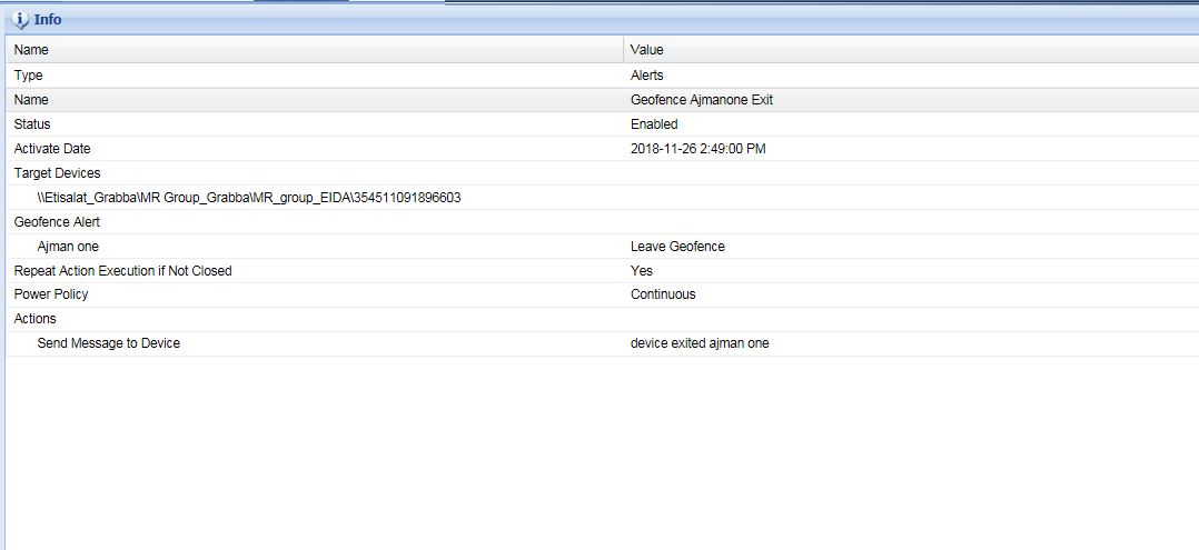

yes i have set alert rule for both entry and exit. device was outside when i created the rule . it exited that Geogence  2 hrs before.
we are using these device for sales and we dont want sales agent to go to another sales agent area.
Also, did you enable the option "" in  your geofence alert rule?
yes i have enabled in both exit and enter alert rules .
