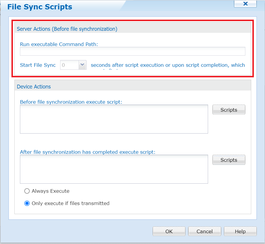

Hi Jose,
FYI, in the latest version of Mobicontrol I believe execute action once file synced is being depreciated.
One other option is to select your device and Action -> Sync Files Now
In the Device Log, you will see "Sync Files requested" and shortly after if the Firmware File is synced you will see another log stating "File(s) synchronized (Total 1 files synchronized: 0 files downloaded, 1 files skipped)"
You can also do this on a wider scale and download the logs for the deployment server (as CSV) and filter "Messages" column for the "File(s) synchronized..." Log.
Thanks
Adam

Hi Adam,
Thanks for the info. On my latest version MobiControl environment I can see Pre-Sync/Post-Sync Script settings under Policy -> File Sync -> Script section.  And there is Execute Script Only if Files Transmitted feature as well. So, it looks like okay to use either 1st option, or 2nd option that I mentioned on my 1st reply. Do you mean this part, if yes do you use a latest version and can't see this section?
For 2nd option, using a Task scheduler or such would be a good use case as well depending on the scenario. I hope it helps. Thank you
Zafer

My apologies Zafer,
I misread the release notes for MC 2024, server side actions which are performed before filesync will be depreciated.
https://discussions.soti.net/articles/file-sync-rule-server-actions-deprecation
