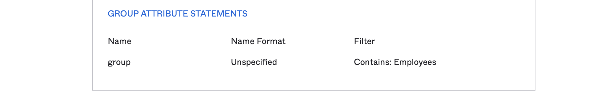

That correct. In OKTA, which is our main user base system, we gathered all our "Employees" Okta group, and map it to a "group" name, which is what we pass then onto Soti as shown in the picture

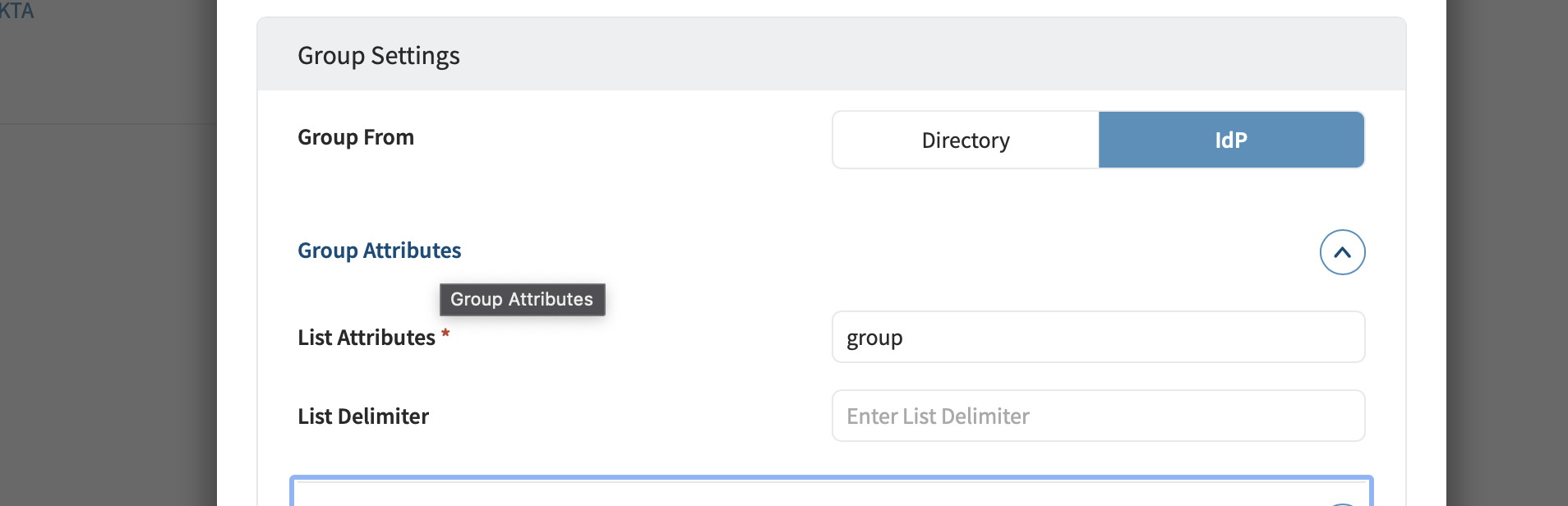

Then in Mobicontrol , all the Group mapping etc, we do it in this way:

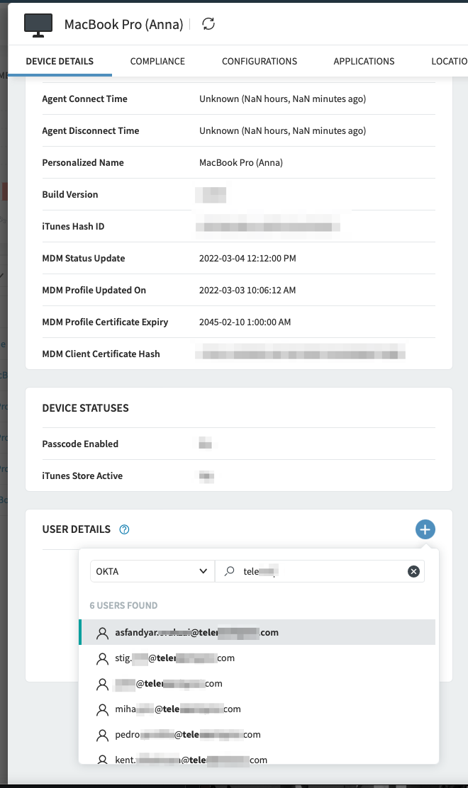

As a result, what we can do only is to pull the users , which we think they come from Okta, but its a coincidence that they are also the Soti Identity Users. And not any user, but only those with Admin privileges, because we cant even pull all of the Soti ID users anyway. As shown below :
The users above are all Soti identity Administrators, but also they are in the OKTA group "Employees", so we don't know what to think. If Okta works for our purpose at all
