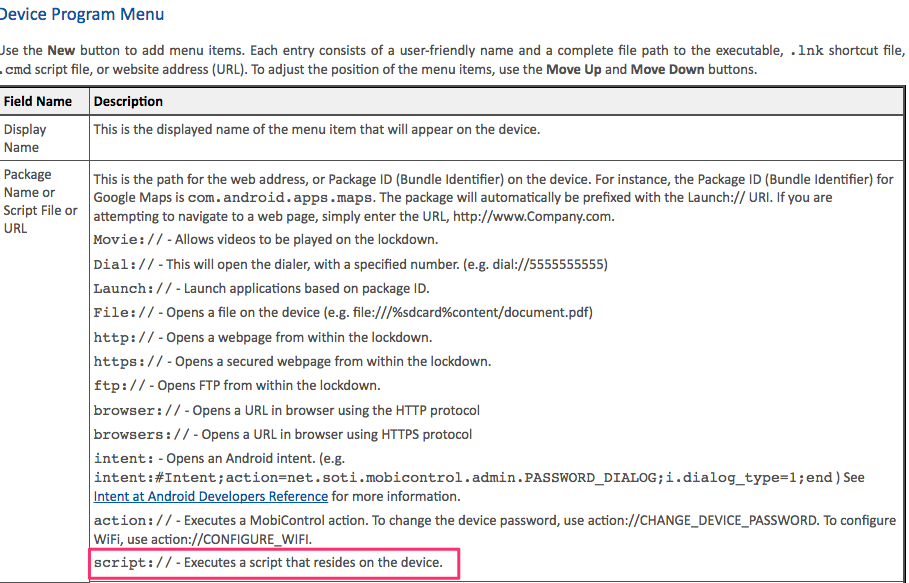

Hi there, I am wondering if anyone has successfully placed a SOTI script on the SOTI Lockdown utility on MobiControl 13.4.
I have attempted to accomplish this but delivering a script file to the desired device then reference that file in the Lockdown config but when tapping on the created hyperlink, it either doesn't have any response or states the file is incorrect. My script kills an app then starts it when executed. I have validated the script syntax by sending it manually to the device.
The Device Script Commands seems to imply this is possible based on the attached screenshot but I would like more clarification on what the file extension of the script file being delivered needs to be and which initialization method I need to use specific to scripts. (Launch://, File://, etc)

Your screenshot was cut off @Ben! Just kidding its listed in the 12.x documentation, not the 13.
