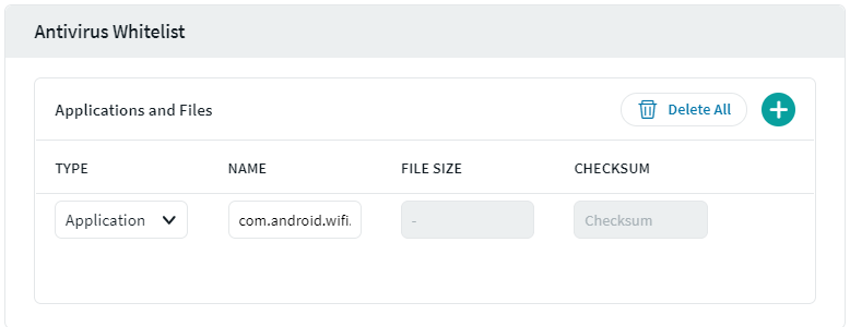

You should be able to configure the Antivirus policy to whitelist the process like below, just paste the full bundle ID into the 'Name' box:
Antivirus Whitelist

Are you referring to "com.android.wifi.resources" being caught by the Antivirus? If so, this simply depends on Bitdefender which powers MobiControl Antivirus profile. If you want, you can open a new case with SOTI Support (support@soti.net) and we can request that this bundle ID is permanently whitelisted in the future to save from configuring a Whitelist every time.
