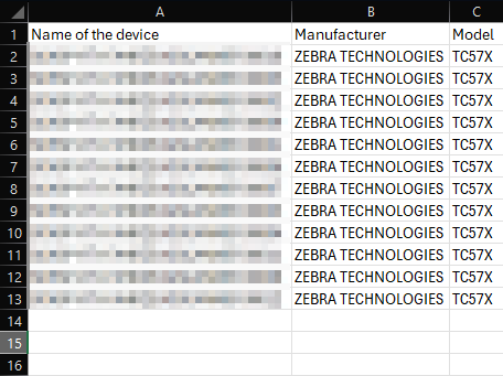

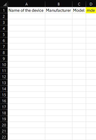

Example:
CSV-Export without custom attributes
CSV-Export with custom attributes (Custom attributes = mde)

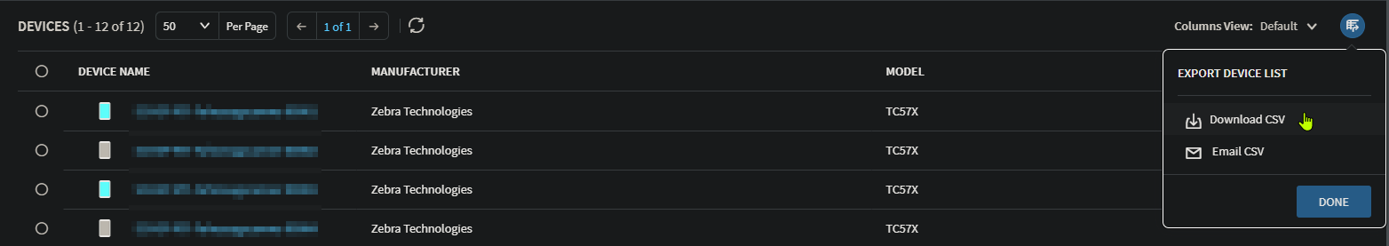

Hi Darius,
thanks for your quick reply.
We are using MobiControl version 2024.1.0.1052.
I’ve attached a screenshot showing how we perform the CSV export.
Please let me know if you need any further details to reproduce the issue.
Best regards,
Fabian
